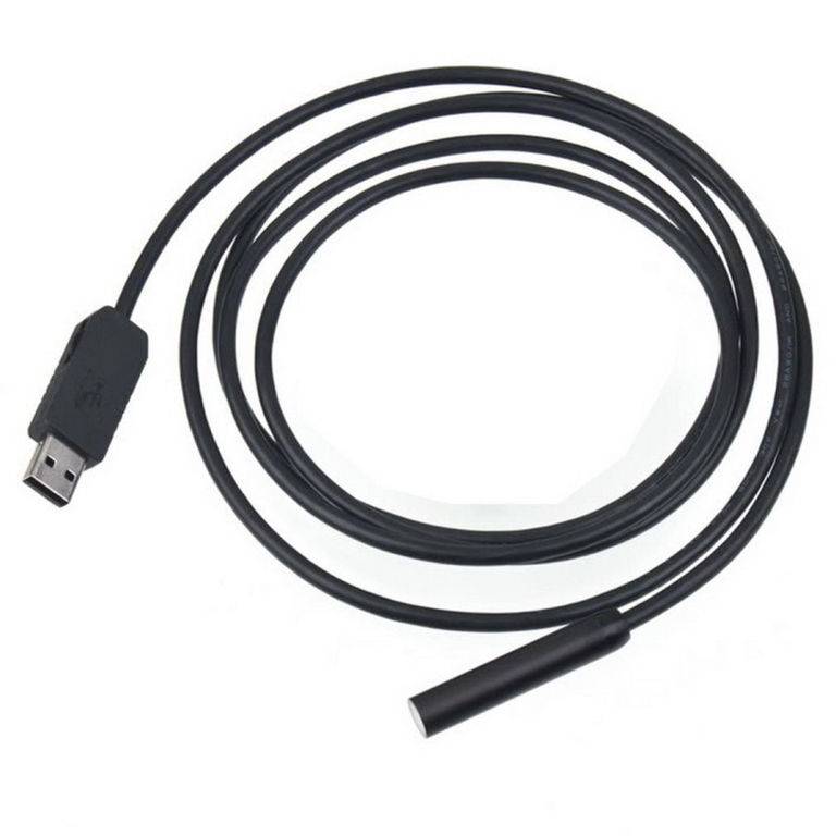

Yep. That cheapo HF gun was a great addition to my tool box thanks to you guys advocating it so much. Worth it!
I just added another little gem, in fact, this morning:
http://www.ebay.com/itm/221863390998?_trksid=p2060353.m2749.l2649&ssPageName=STRK:MEBIDX:IT
FIVE DOLLARS AND THIRTY SEVEN CENTS ???? A No brainer!

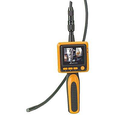

Stan,
I have one of these made by Actron. Tried to use it to find the blockage in the A/C ducts and heater box. I was very disappointed with the display results....couldn't see or decipher a damn thing! It is my own damn fault for not opening up the heater box when I had the damn dash tore apart!
Stan,
Sorry that your inspection camera turned out to be crap. That's the trouble with all the manufacturing going out of the country in search of becoming as cheap as possible. Everything is hit or miss today, mostly miss.
It may be bcause yours is an All in One unit. Mine plugged into a tablet or laptop for its display.
Problem is usually video quality... I bought a cheap one similar to Stan's for a quick check of the house's drain pipes... 50' and under $30 several years ago... too crappy to use on an engine though.
We have some Snap on video scopes at work that are much better, but the cheapies at HF are catching up to the quality (5 years later). Worst part about the EB versions is you need a mirror kit to check cylinders and enough resolution to make out problems.
