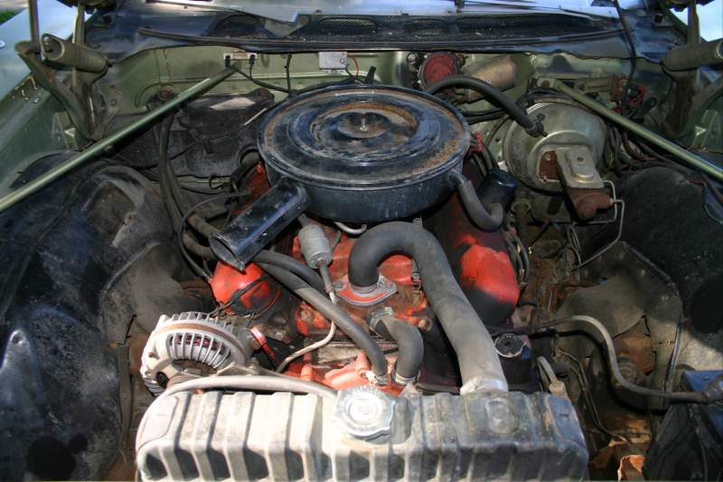

My 318 is Chrysler Red. Although it looks more like a red orange right now. I know that from 1969-1971, there was a Police Only 318 4 barrel in H-Orange. I will be modifying the internals of the 318. So, not sure if I will stay with Chrysler Red or go with H-Orange. I do like the idea of IH Red though, never thought of that. Then there is a part of me that says, keep the original paint too. Hmm! decisions, decisions!
