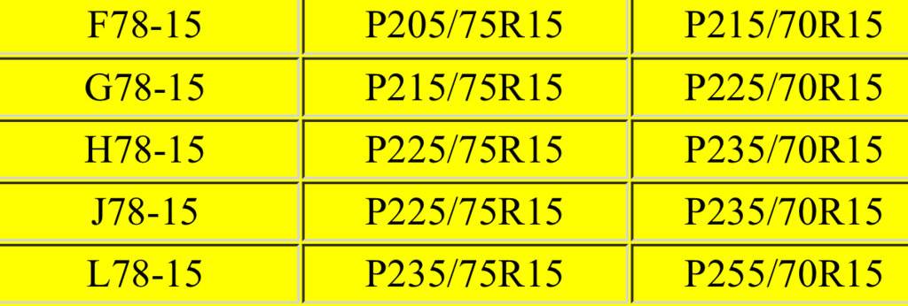

This must be a limo. Tire size equates to P255-75. See:
www.vintagetire.com
Dave
Looks to be 235 in a 75 series and 255 in a 70 series. Thanks for the link.
Difference between 225 and 235 overall height is about 1.4”
That’s almost 3/4 “ increase in height... noticeable.

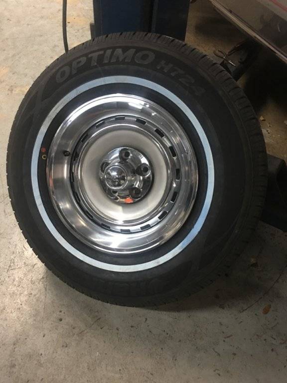

I just bought some 235’s for the wagon about 3 months ago and just decided to do the same hankooks in the same size for the NYB
I’ve had classic tires and vogue wide whites and they always developed flat spots after a week of parking. They rode lumpy for at least a day....
These hankooks are much less expensive and the ride is superbly smooth... and isn't that what these cars are all about.
Agreed -- looks great! I have looked for places selling road wheels. I musn't be very gifted, because I have found none so far. Suggestions?
See you at Carlisle. You WILL find a set there. How perfect you want them is the problem here. I am looking for a GREAT set for my blue car. I find 1-6s on a scale to 10 at Carlisle. They are there, but not great sets

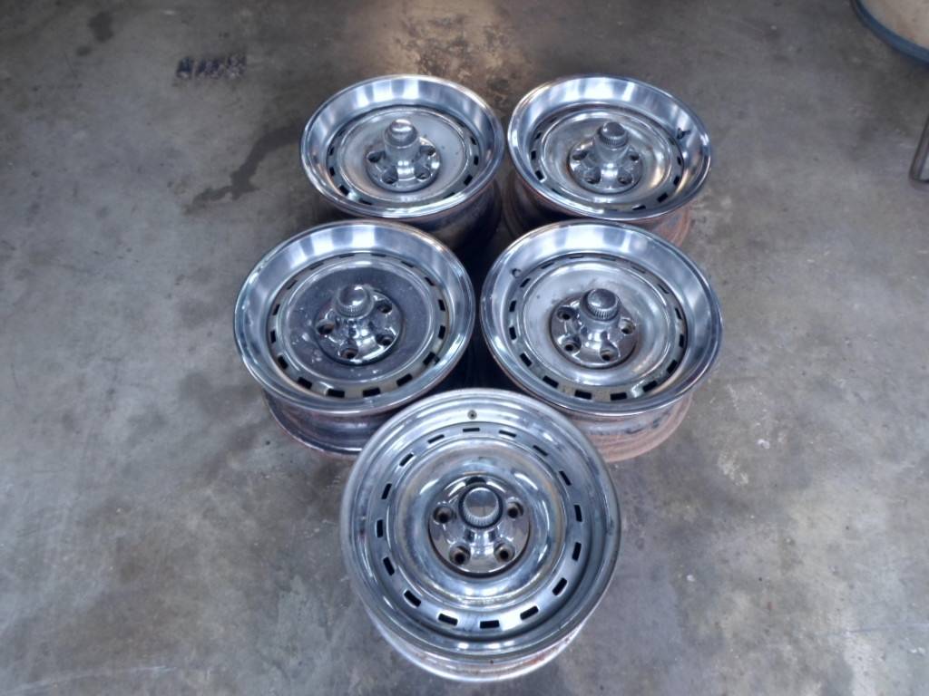

The last of them in 15x7 are very hard to find... expect to have to pay. If you're impatient, there is a set for sale right now.
Edit: these are NOT 15x7. For Sale - early 70s 15 inch c body rallye wheels he has incorrect rings, but they would be a low dollar starting point available right now.
I paid $375 for these, shipped, and am still glad I jumped fast...
Early centers are even tougher to find.
