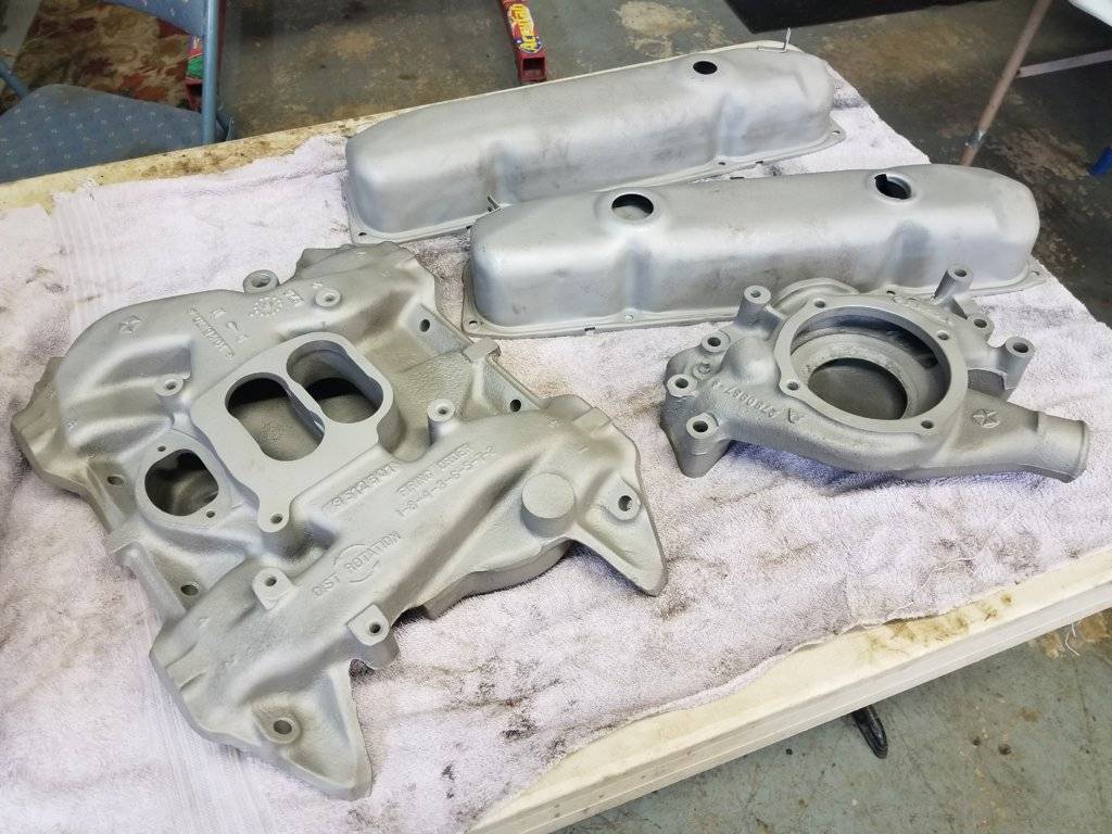

While out of the office today I got a call from the powder coating company to let me know the parts I dropped off for sandblasting were ready. So I stopped over at their place to pick them up on my way back to the shop.
They turned out nice, and will be thoroughly blasted with the air hose to remove any remnants from the sandblasting before they get painted.

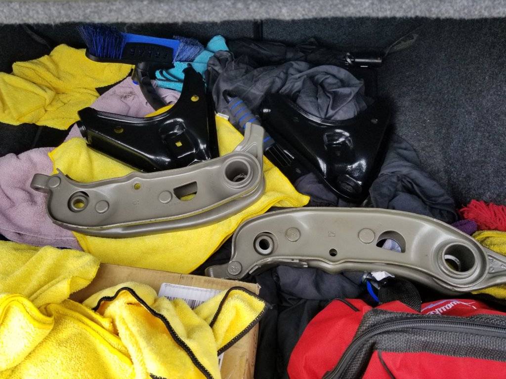

The guy doing the sandblasting was one of the guys that brought the stub frame back to the shop after it was powder coated.
While at their shop today, he told me he spent additional time on the water pump housing and intake to be sure no nooks & cranny's were missed.
I'll probably invite them over for a beer or two when the weather breaks.
Tim if you have a parts washer direct a continuous stream of fluid down through the vent opening on your right valve cover. This will remove sand blast material that is very hard to retrieve. This is a must do as bearing contamination and failure can result. Change the direction of the fluid every 15-20 min to assure best results
Don't forget to do the same on the intake -- every runner, bolt hole and crevice will hold media. Do NOT stand over it while blowing it out with compressed air to dry it or ya might lose an eye.

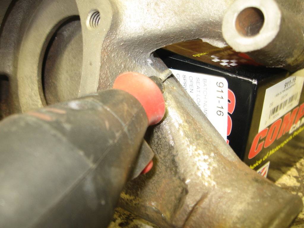

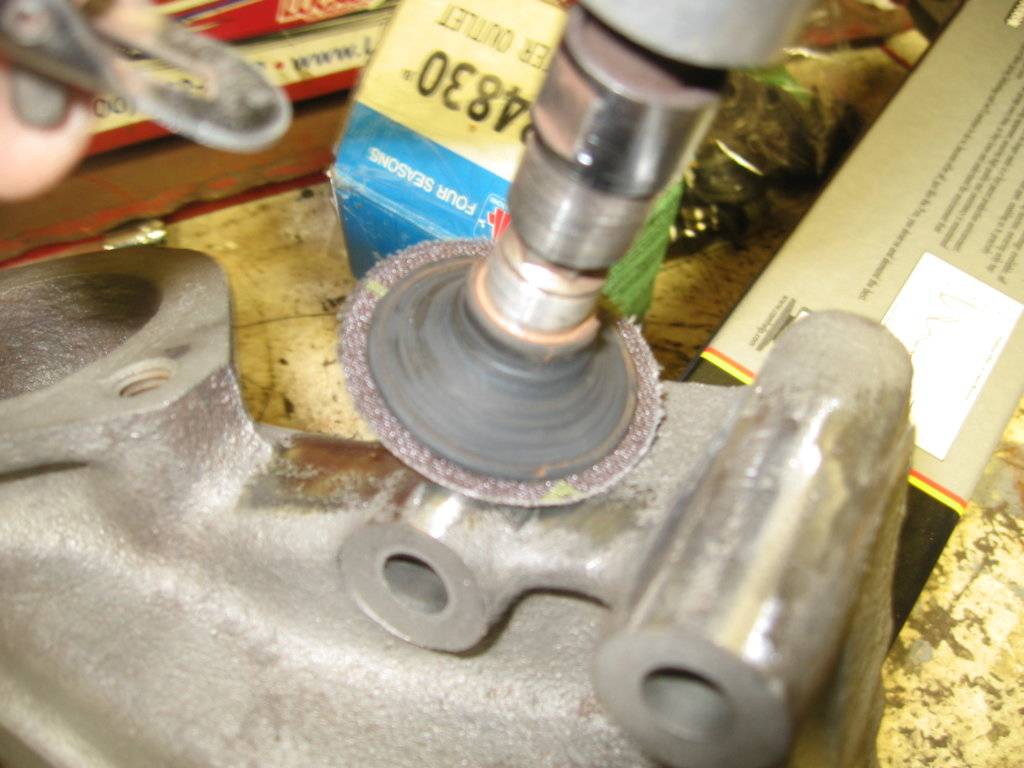

To go the extra mile,I grounded off the casting lines on the w/p housing for a smooth look..A small detail but I recommend it!

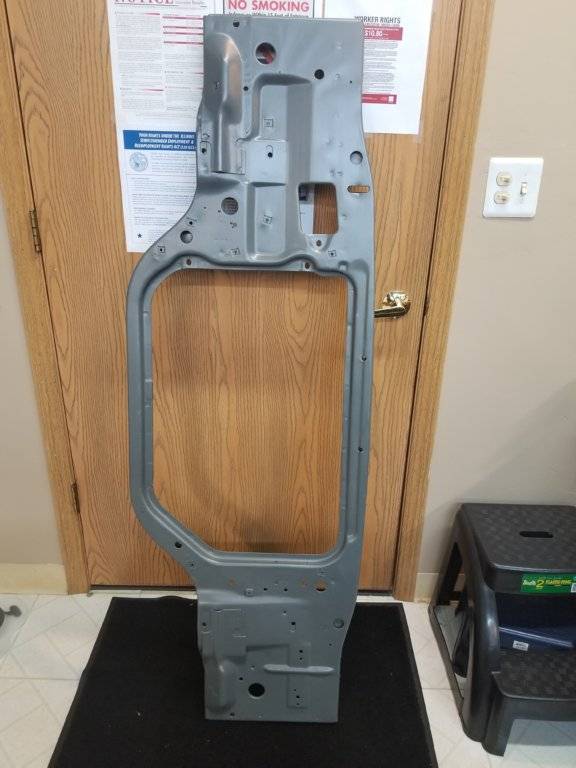

This morning I dropped off the core support to have it sand blasted. The place I've been taking parts to for the sand blasting got slammed over the last week with orders, but I should have it back by end of the week.

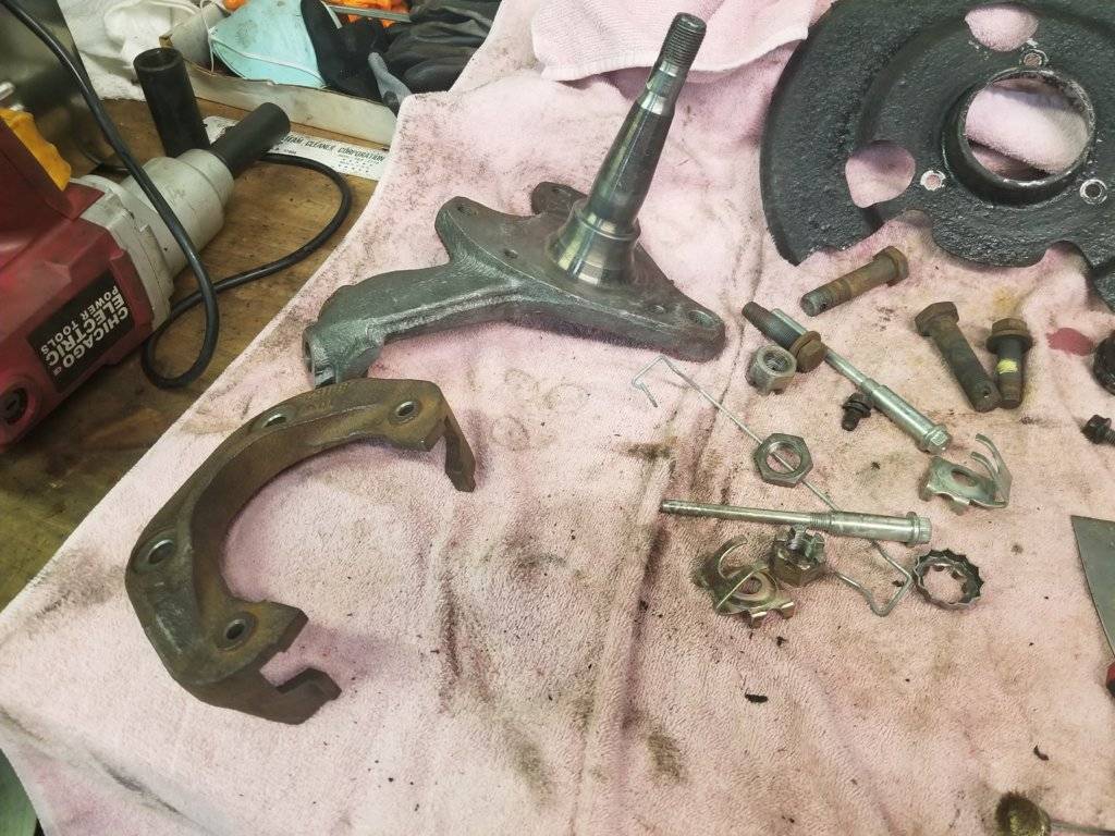

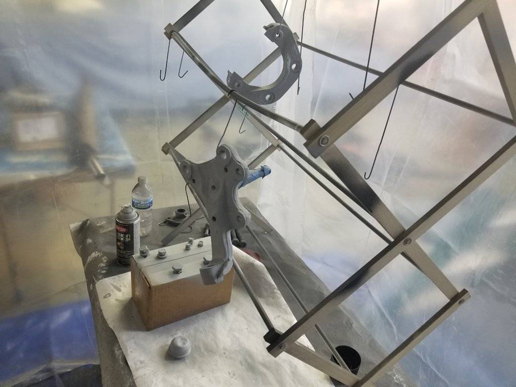

Started cleaning up the spindles today. After degreasing them and a couple cycles through the sonic cleaner, I took the wire wheel to them to remove any remaining crud, taped off the spindle and shot some primer on them. I'm surprised how much weight that $10 Wally World towel rack can hold.
Paint and reassembly of the front brakes are next. One more to do.
The powder coater called to let me know the core support was finished, so I drove over an picked it up.
When I took it over to them, I asked to have it sandblasted and primed, but I didn't expect them to powder coat it in primer.
They told me they don't do any liquid materials there, so this was a nice surprise. It came out very nice.
I already have the crystal dawn metallic paint, so it gets rattle canned soon too.

Everything is looking great, but it looks like you need some clean disc brake shields to match the level of work on the other parts :poke:
