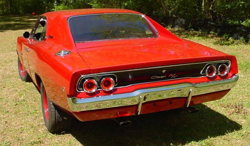

The 8" steel wheels were standard equipment on 4X4 Ramchargers and Traildusters. I ran a set with 275's on the rear of a 69 GTX and with great effect. The same wheels are now on my brothers 68 Hemi Charger.

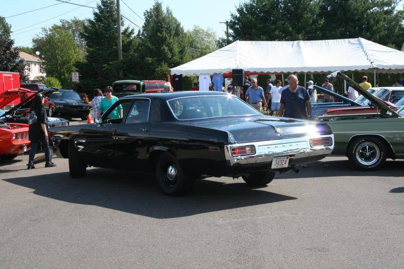

235s... all the way around
275s ..... rears
255's rears
275s all the way around..... looks silly
The 255s look good, what size rim? Are they on all four corners or just the back?
Based on the bulge of the tyre, I'd say a 7" wide rim. If it were an 8", there would be less bulge.

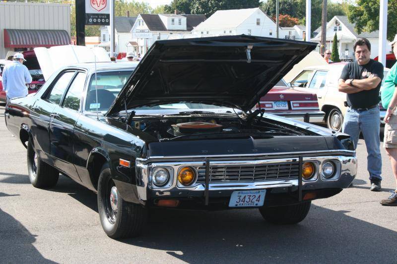

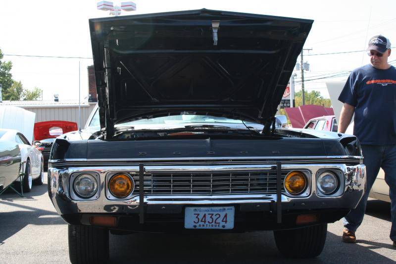

That black '72 Dodge just looks downright mean, good wheel/tyre combo. Any idea of what that lad has on there?

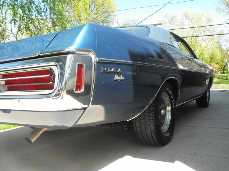

Currently have 255 70 15's on 7" steelies, all the way around,may be a tad wide for 7" rims, but I also like a wheel well filled with rubber, haven't drove the car much but may go with a 235 75 15 in the front due to clearance issues in tight turns. Mathematically really close to the same dia.
