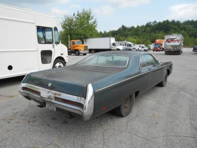

It does interchange with other Chryslers. The fiberglass insert is the Imperial-exclusive piece.
So does other back windows will fit when I remove the fiber glas insert or not? Becasue I don't want to keep the vinyl roof and the small window would look studip with a painted roof, I think.

My question is, is the window crown imperial specific or the same like the 300, new yorker or newport, ...? I think it would be difficult to find the window if it's crown imperial specific!
Are not all the fuselage c bodies (Chryslers) all the same from the fire wall back?
Just the details, just the details......
One Imperial front clip, one Newport convertible body, quarter panel caps, decklid, tail lights and rear bumper from that Imperial and you've got yourself an Imperial convertible.
More or less.
Chryslers and Imperials do share the same sheet metal from the firewall back, including doors, roof, and quarter panels. There are differences in the aft portion of the trunk area mostly owing to different taillight treatments (I think). If you look at a bumperless Imperial and a bumperless 300 or Newport, you will notice different stampings. The Imperial bumper will fit on the Chrysler, however, as long as you install the proper fender extentions. Those extentions are model-specific and are different between 2 and 4 doors of the same model.
Great, thank you! Now, it's just the problem to get a back glass to germany left. ;) But it should be lot easier to find the part now!

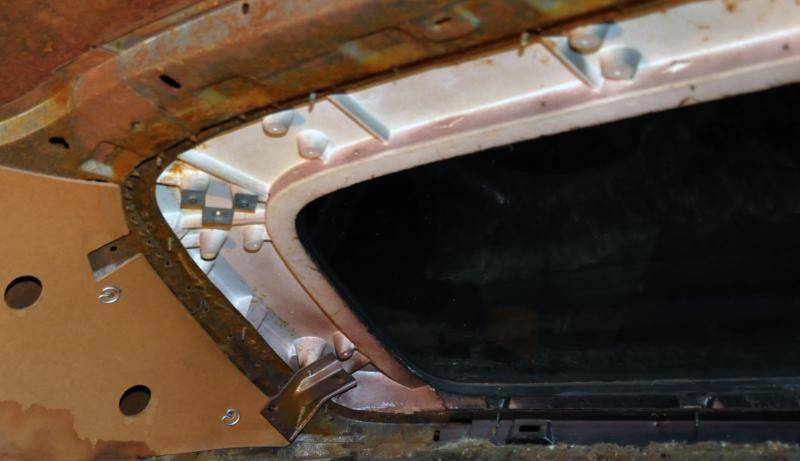

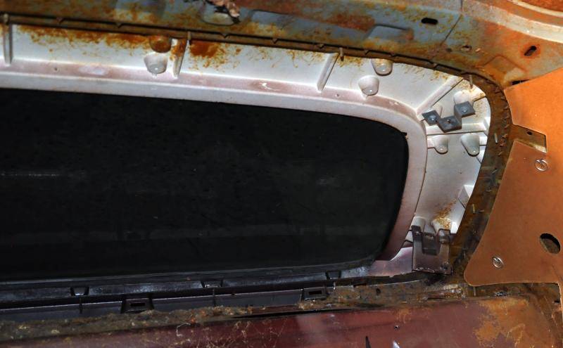

Is the back glass broken or damaged?
As I understand it, the fiberglass insert is just laid over the window and finished. I would think you just have to take the fiberglass insert off and clean up the rear window.
I wish it was that easy. :/
The fiber glass insert is bolted to the big window frame, so the frame should be good for the big window, but the glass is a smaller one inside the insert.

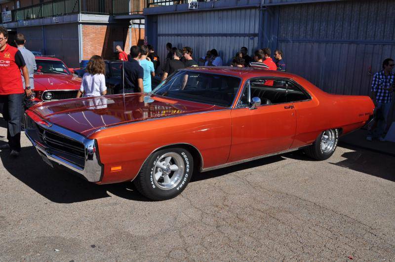

I'd be tempted while digging into this that deep already to make it a large rear window/no Vinyl top car, but this would cause another search for different interior parts as well. These cars look way better that way IMHO.
The same way that the Challenger SE smaller rear window was done.
I love the original look alot! But I decided to go with a more sporty look.
I like the bodystyle and image of this and planing to go in this derection with my coupe.

If you're willing, I very highly urge you to go the no-vinyl route. It's far sexier without it.
