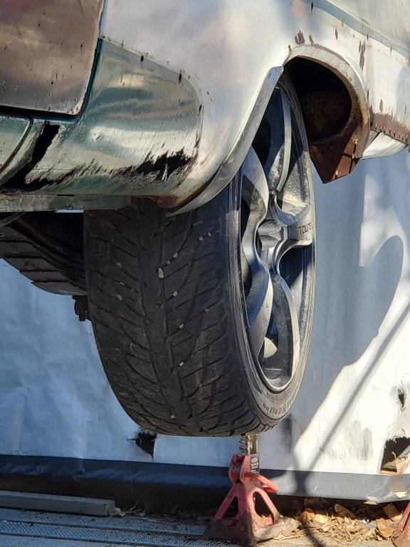

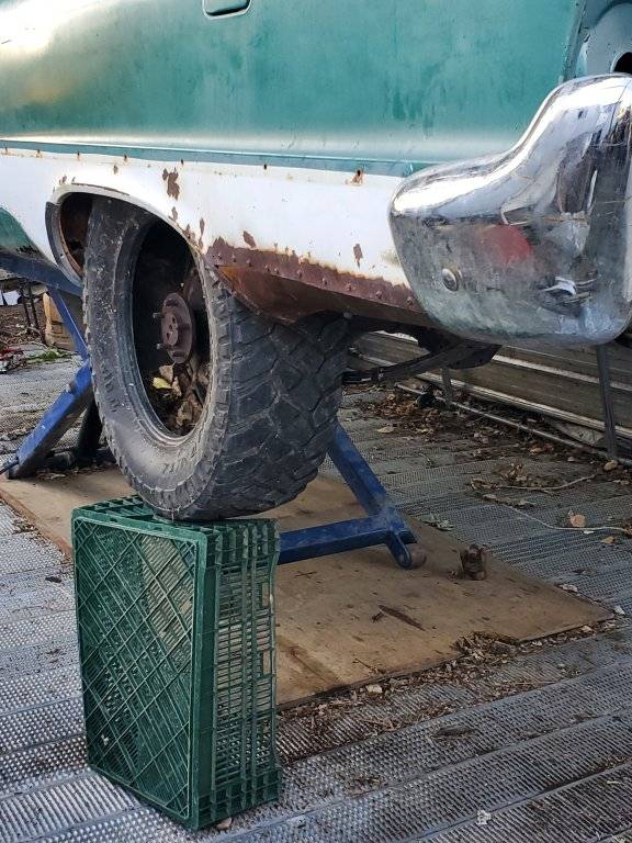

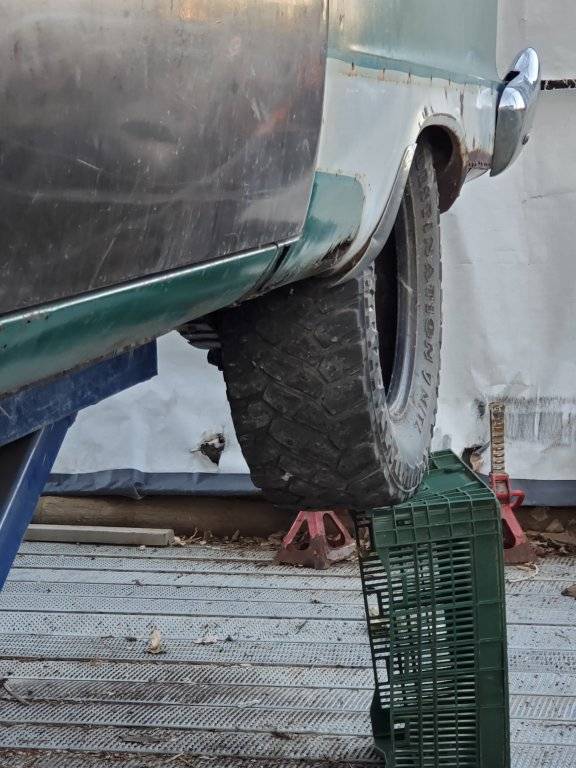

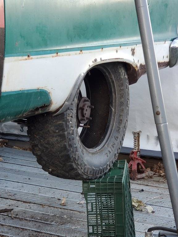

That is not a good way to support the car. Use jack stands or at least something a little stronger. As commamdo1 said, "that bead isn't sitting right". Is that tire mounted, or did you just stick it on to get an idea of the fit?
The car is fully supported on a scissor lift. I looks like he mounted a tire on a wheel and didn't air it up, stuck it on the wheel studs, and supported the tire on a plastic crate just to see what it would look like.
That would be funny sitting a car on plastic boxes.

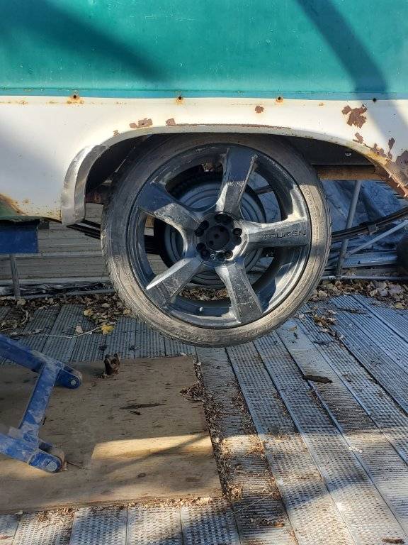

These are my 18"
Now, I'd like larger tires.
Maybe a 275/70R18.
Not these but used for visual.
Of course they would stuff better with weight on suspension.
Looks like I'm going to cut the wheel well. Have to to make a tire like that fit.
Maybe a 275/70R18.
If you're talking about cutting the forward part of the wheel well for fitment, consider moving the rear end back 1/2" to 1" instead. The way I did mine (in a Dart), was I drilled another locating hole in the spring perch. You can also put a spacer in front of the forward spring hanger, but that changes the angle of your shackles.
