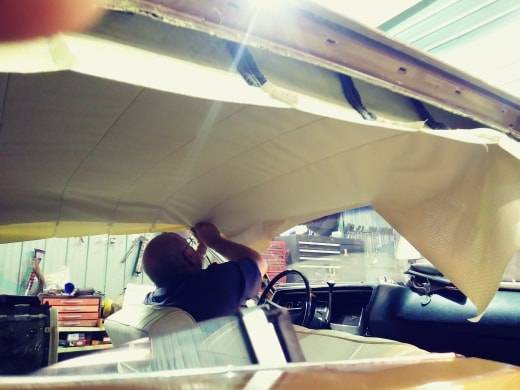

    Yes you have to gently pull the weatherstripping to access the screws that attaches the chrome strip to the car. Ditto sun visors,coat hooks,sail panels,etc.
    From there the headliner is ready for removal.
    BUT I let my professional handle it from there.
    Upholstery guys are particular and I learned it is very important to leave the material on the bows. The pros then use the old headliner as a REFERENCE to stitch up the new headliner onto the bows for a correct fitment.
    I did post my install on this thread
    Meet Maggie May!
