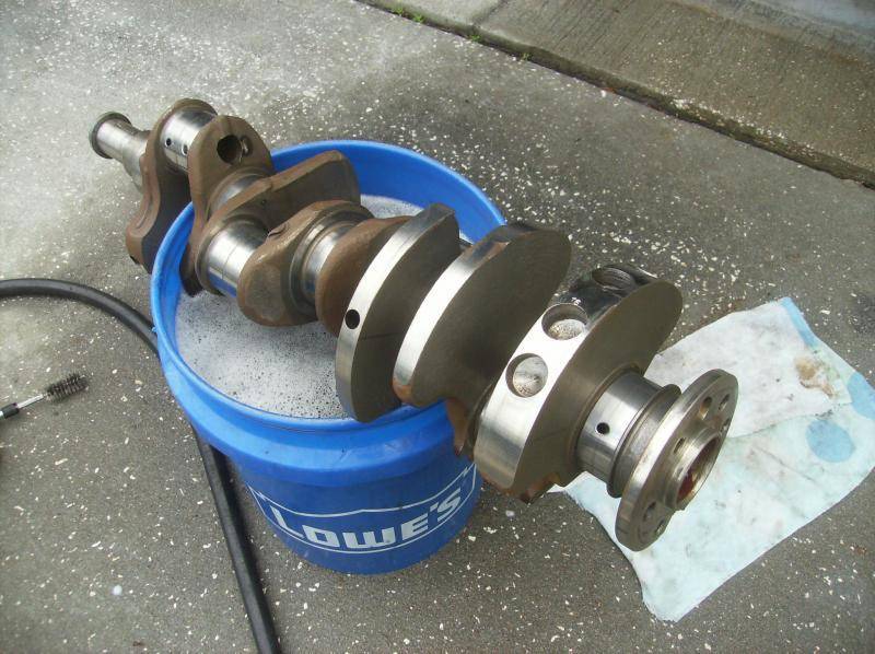

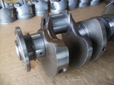

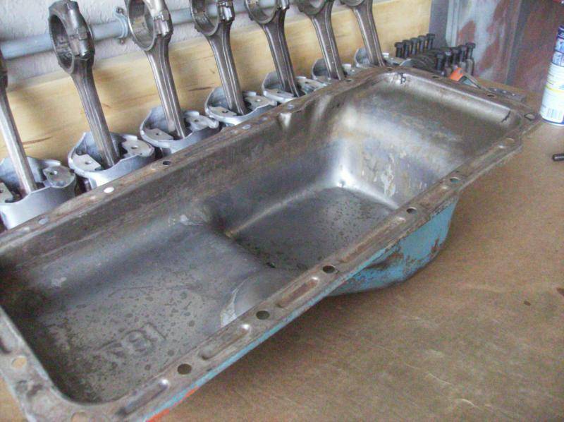

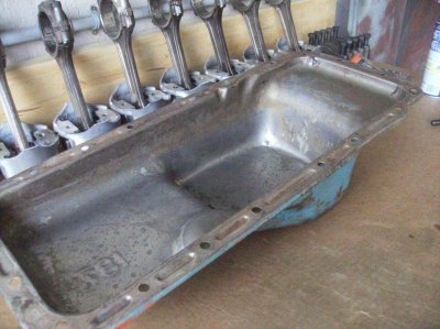

Quick update. Today I gave my crank shaft a bath. Now there's something you don't say everyday. Yesterday I finished cleaning the pistons and connecting rods, and cleaned the oil pan. Looks like someone tried to jack up the car by the oil pan. I hammered it back into place. next I will sand blast the outside to remove the rust, and give a coat of primer.
Thanks. Just a thin film of wd40. I still need to polish the crank so trying to keep clean for now.
Thank you. I was thinking I should spray down my exposed metal surfaces with WD40 or PB blaster or rub it down with motor oil. It's still on the stand
