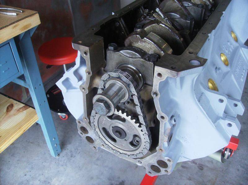

What are those notches on the crank throw on the journal end?
Balancing?
I talked with a friend at work, who is helping me with this build, and he believes they are for balancing. A great guy who's been a tremendous help. Thanks Brian.

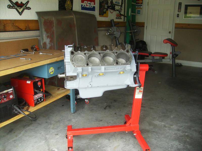

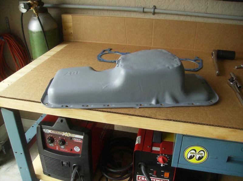

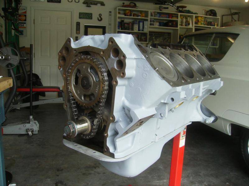

Quick update. Last weekend I got the rear seal, cam and crankshaft installed, and put a coat of engine primer on the block. Got the pistons assembled during the week. Yesterday I installed the freeze plugs, pistons, and timing chain. Today the oil pan got sandblasted and a coat of engine primer. Next onto the lower rear seal , and oil pump.
