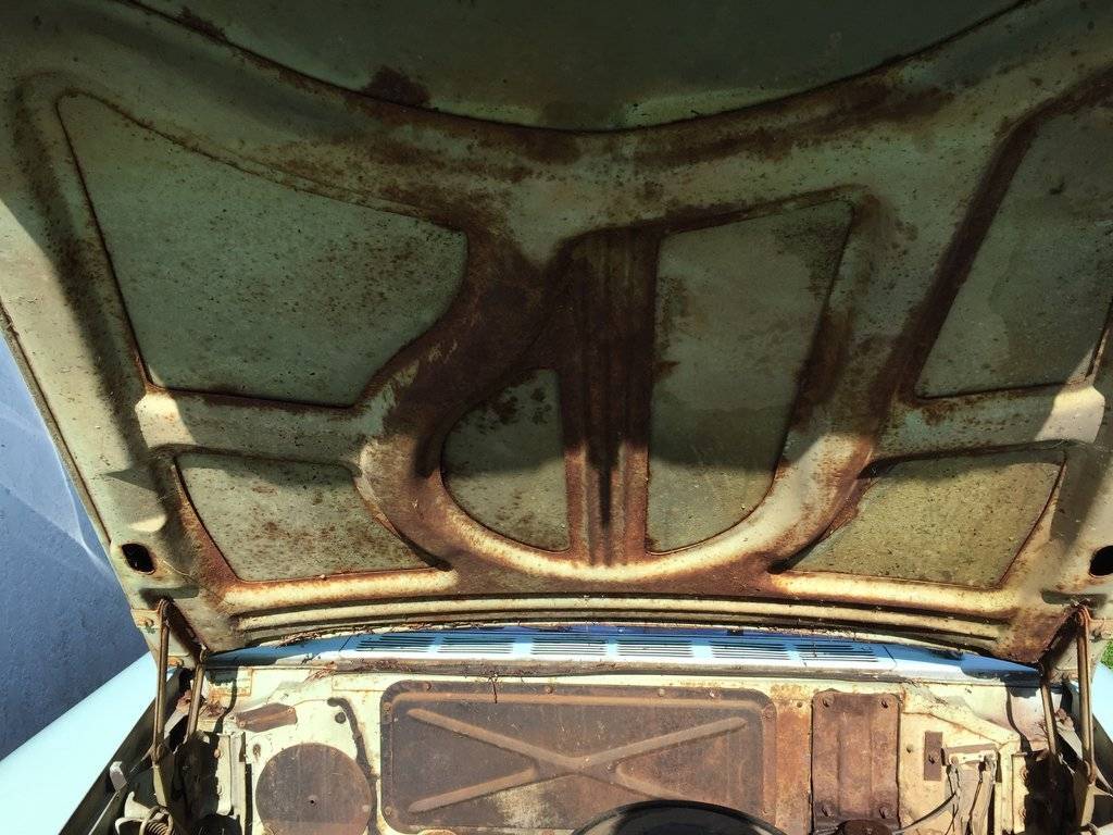

Now this grabbed my attention. Interesting hood brace, it makes me wonder did they use a different one one the 8 cylinders or why did they choose this over a symmetrical brace? Maybe A/C compressor clearance?

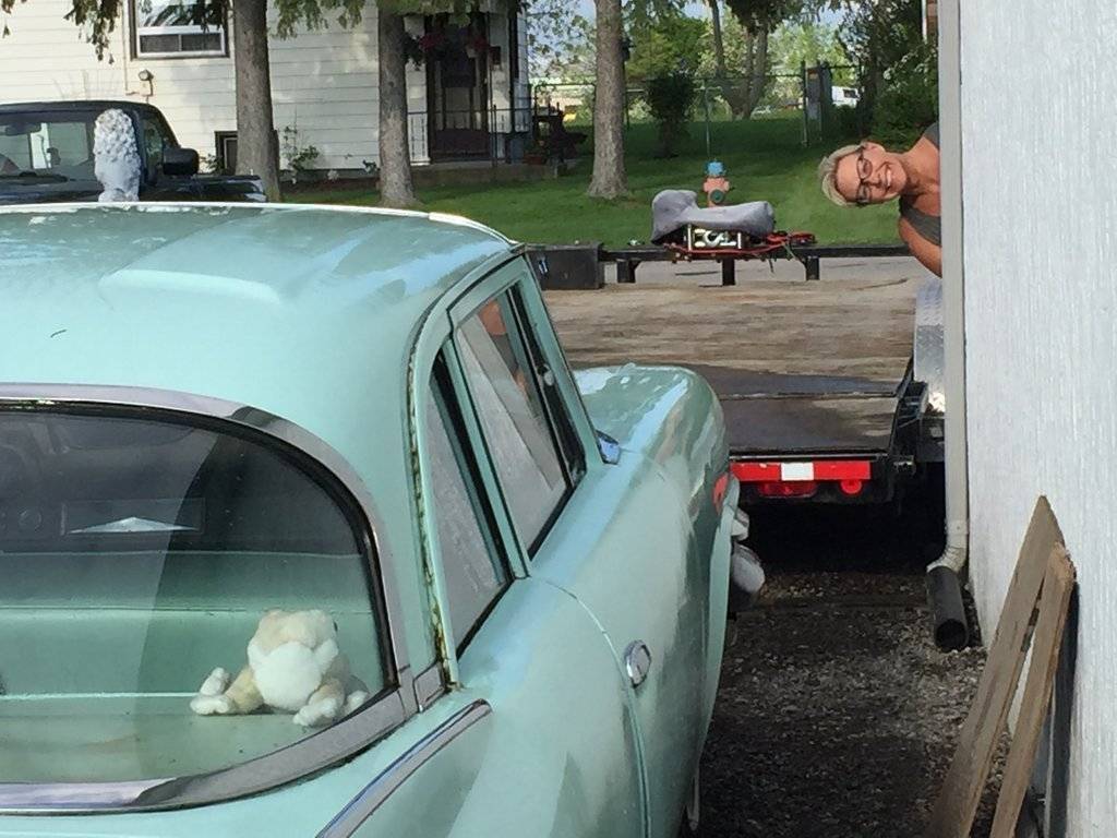

The duct work is from the aftermarket heater box on the passenger side. - I was crawling under there yesterday in the mouse turds and seed shells...
The button on the right where it might usually have the defrost button is labelled "AIR" which actuates the control for the fresh air vent just in front of the wipers on the outside of the car.
Since this is my first FL almost anything goes for what this car has until I find out it shouldn't be there..
Heck I thought the frogs in the back windows were factory option until my local Mopar buddy told me they weren't!
:lol:

Now this grabbed my attention. Interesting hood brace, it makes me wonder did they use a different one one the 8 cylinders or why did they choose this over a symmetrical brace? Maybe A/C compressor clearance?View attachment 126312
I noticed this too...
I just saw a V8 version with the same brace online
