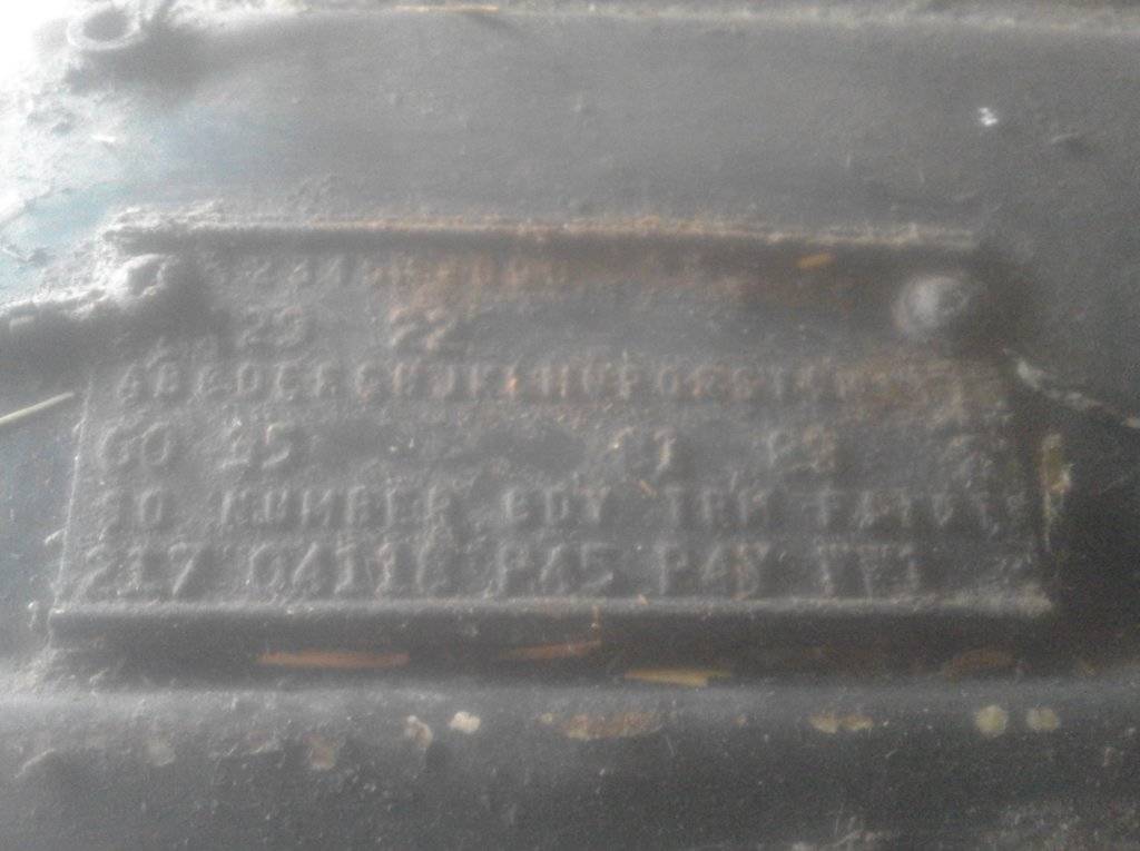

Indy Pace Car? Wondering if someone can decode the fender tag for me.
66 pf
May 27, 2019
7
8
mankato minn
Im trying to figure it out with that link, but so far i only understand the ww1 in the lower right corner means it was white
217 = Feb. 17, build date
P45 = Plymouth Fury, premium class, convertible
P4Y = bucket seats, gold
WW1 = white top, white body paint color
AB60 = 383 2bbl
D5 = automatic transmission (TorqueFlite 727)
Q1 = Music Master radio
T8 = tachometer
V3 = back up lights
22 = fender skirts
39 = variable vipers with washers
Z2 = front bucket seats w/ a console
AB60 = 383 2bbl
T8 = tachometer
V3 = back up lights
22 = fender skirts
Thanks so much!

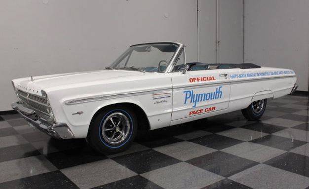

That,s not a pace car…...
The pace cars interiors were blue and sport fury,s , not plymouth III
Not a pace car but white over white with gold interior, buckets, a BB and a tach, I'd be as proud as a pig in **** to own that car.

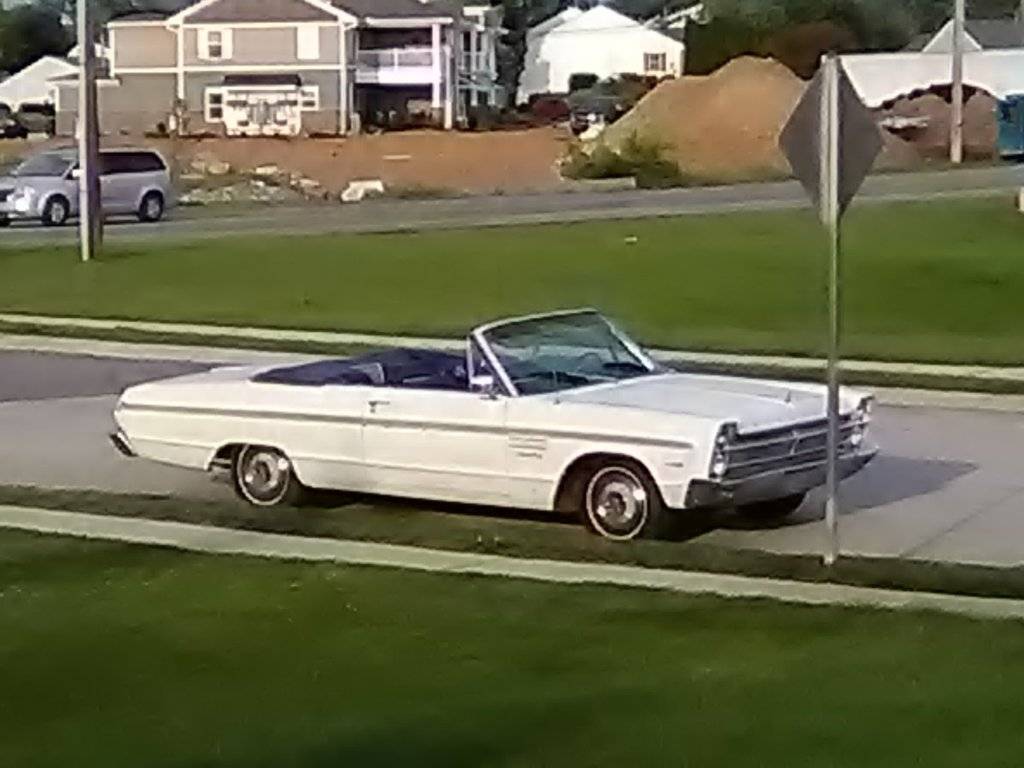

Theres 1 for sale in wash. state with a vin of P45222857. Mine is P45223089. Thats only 232 diff, and 1900 were made. Its also possible not all were blue interior with a blue top. It also has the sport fury logo on the trunk, along with an auto shifter that has a hurst logo and INDY going vertical. Ive been researching for a couple weeks, and Ive seen where some of the pace cars didnt even get the indy decals. Theres several weird things with this car, im just looking for info.

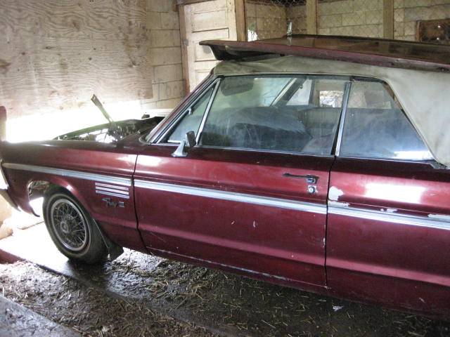

Theres 1 on Mecum Auctions with white exterior and red interior. Look up Kurt Carlson collection, it was at INDY Mecum in 2010.
Is there a list of pace car vin numbers? Is that in the Chrysler archives if such a thing exists? I may have one of the dealer replicas. Sport Fury vert with 383 4 bbl White with blue interior. Is there any definitive way to confirm? Thanks Retroman.

Supposedly the Pace Cars that the dealers got had the blue interiors, and the cars that were used at the race had the red interiors.
The automatic shifter in the Pace Cars were the regular shifter just like every other '65 C-body with a console shifter, and they didn't have any writing on them.
