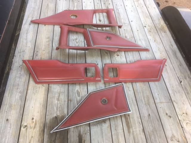

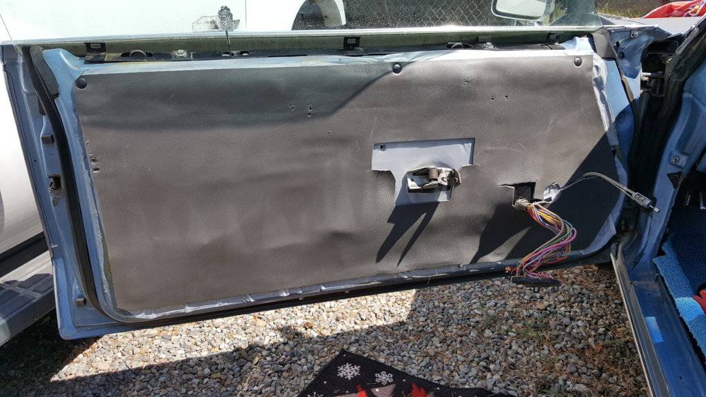

Current work - Been working on the door panels, replaced the carpet at bottom of the door panels. Had to splice in a piece of sheet metal where the plastic on the lower door panel has broken away. A. full strip of sheet metal is on the back side
Replaced plastic liner and felt padding with 1/4 thick neoprene insulation - see below:

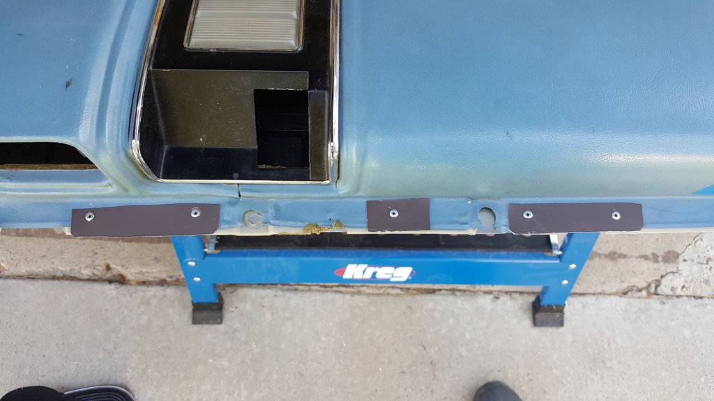

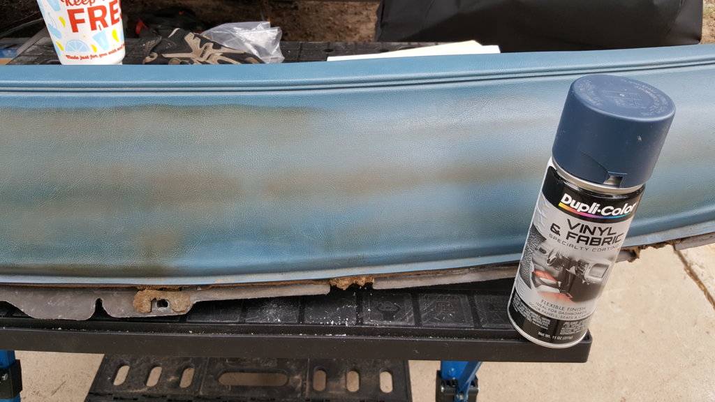

I am trying to find a color match vinyl spray paint so I can paint my dash pad. Duplicolor med. blue is too dark - see below:
Got to keep searching for paint, I may have to blend this medium blue with Duplicolor light blue.

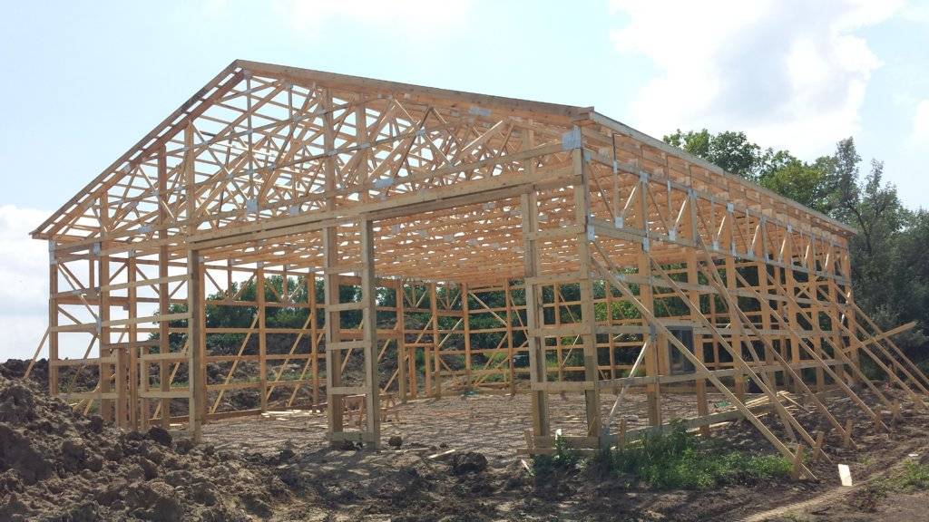

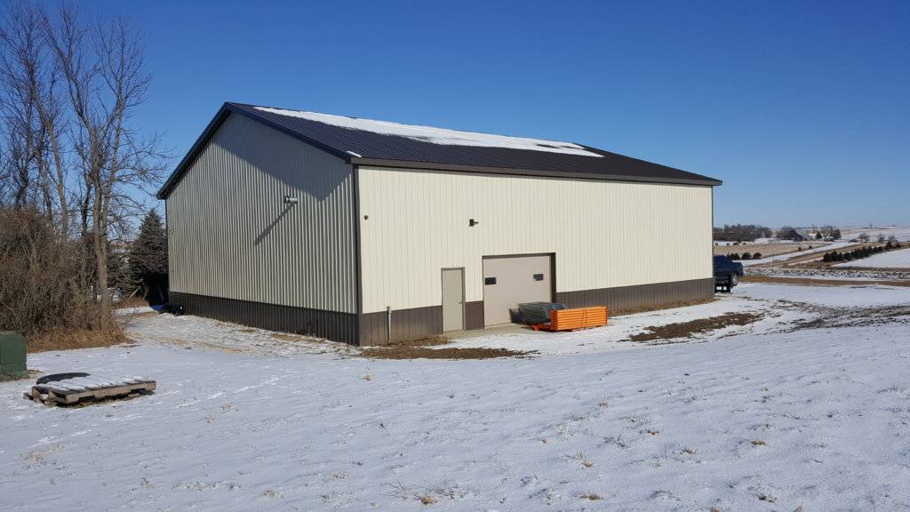

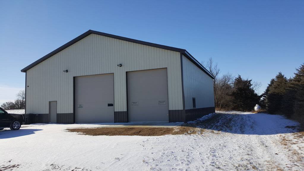

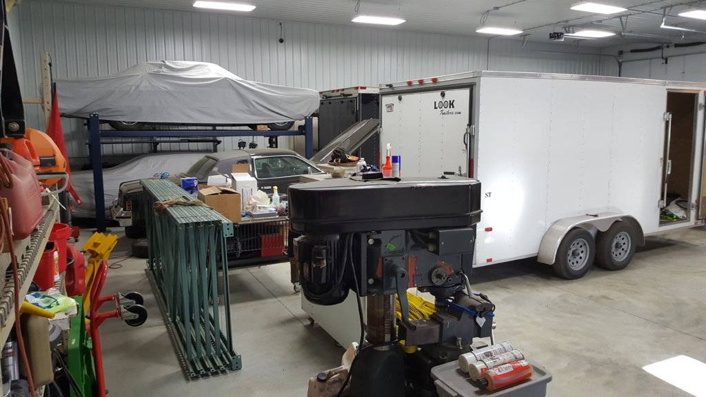

Yes, after reading Javier's posts, I decided I would start my own thread. I have already built my shop in SD already. I will post pictures of the shop soon. It is 54 by 64 with two four post lifts. My 26 foot car trailer is in there along with the two 72 Fury, the 75 Doba, and the 75 Imperial. Then there is the compact tractor, skid steer, and forklift!

As to painting the dash, Sherwin Williams here has an auto paint outlet that has color matched and loaded some spray cans for me recently. I would look to them for your dash.

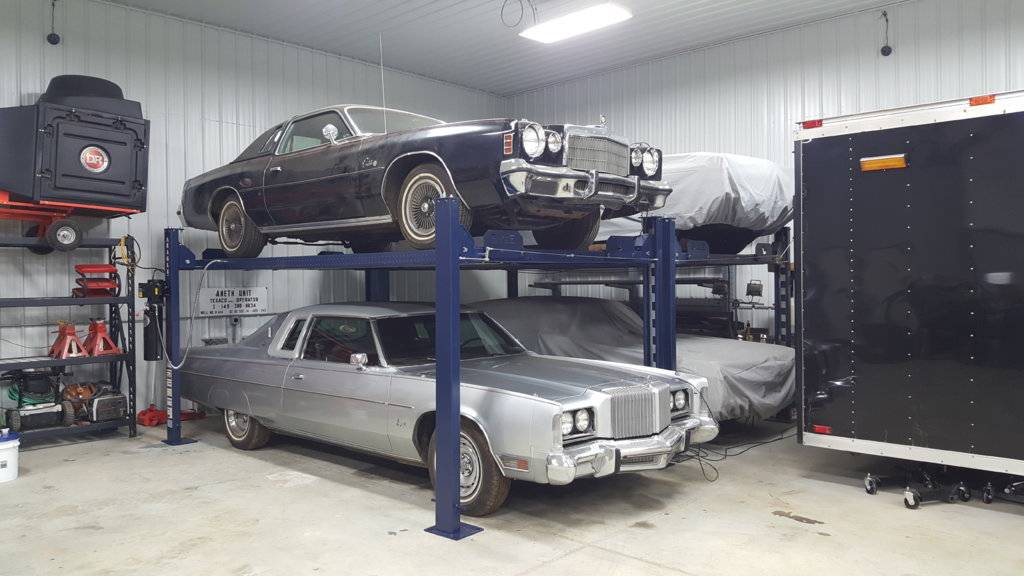

Some pictures of the shop:

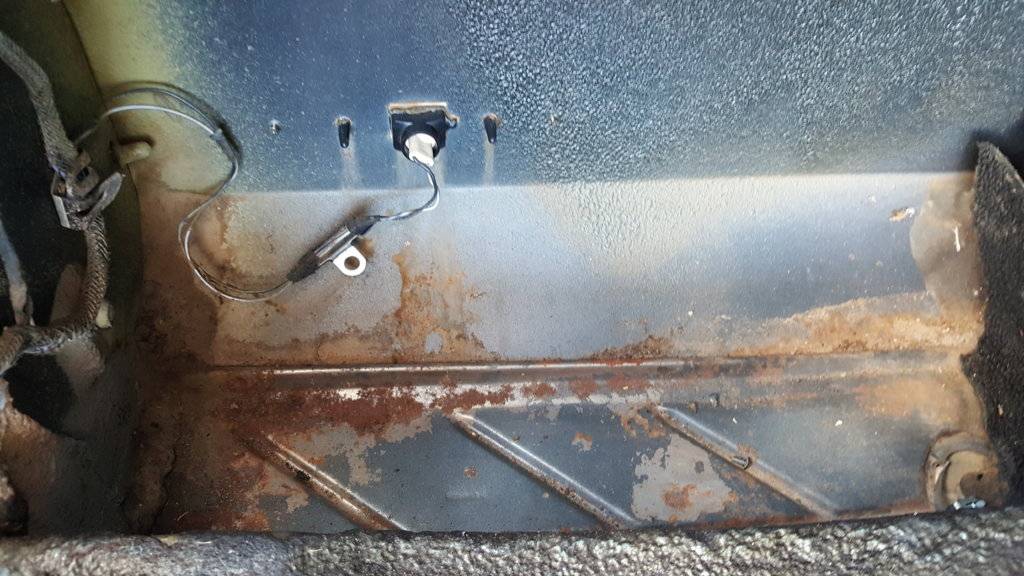

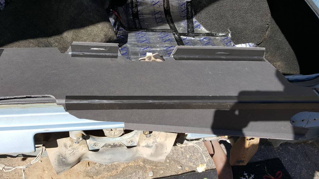

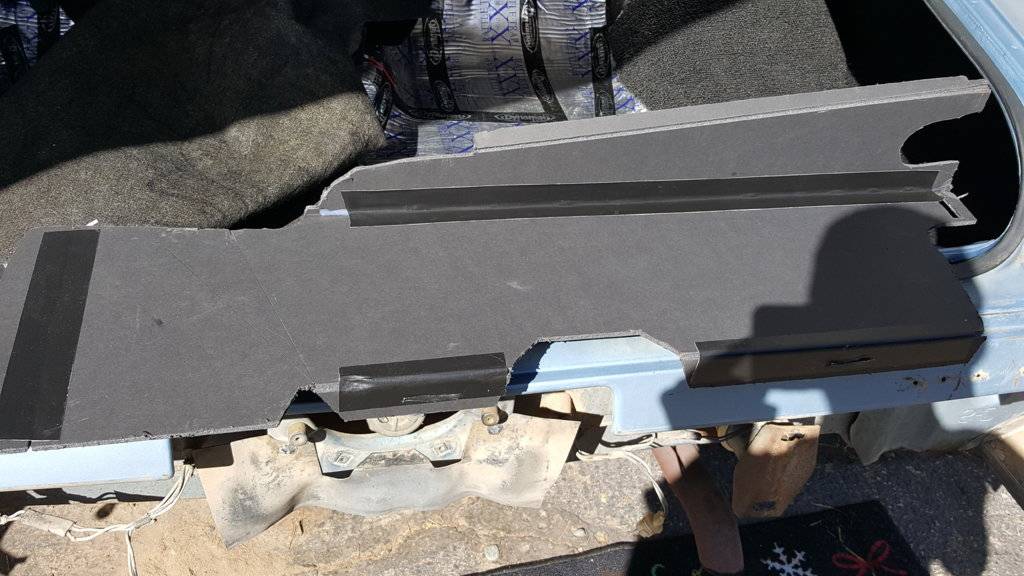

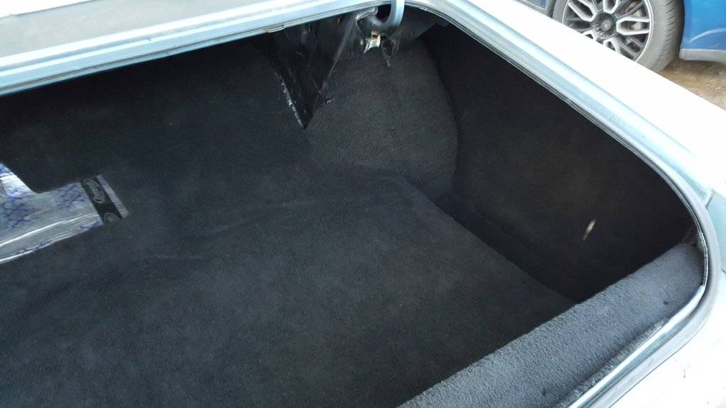

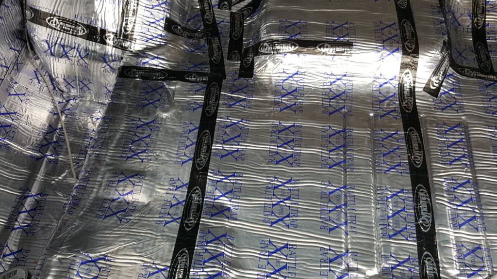

Finished the trunk, had to treat the rusted fender wells, put in sound deadener, shampooed the carpets, built new rear panels around the trunk lock (old ones were badly beat up) out of foam board, and applied carpet, put new backing card stock on the side panels. Some pictures:
Before;
After:

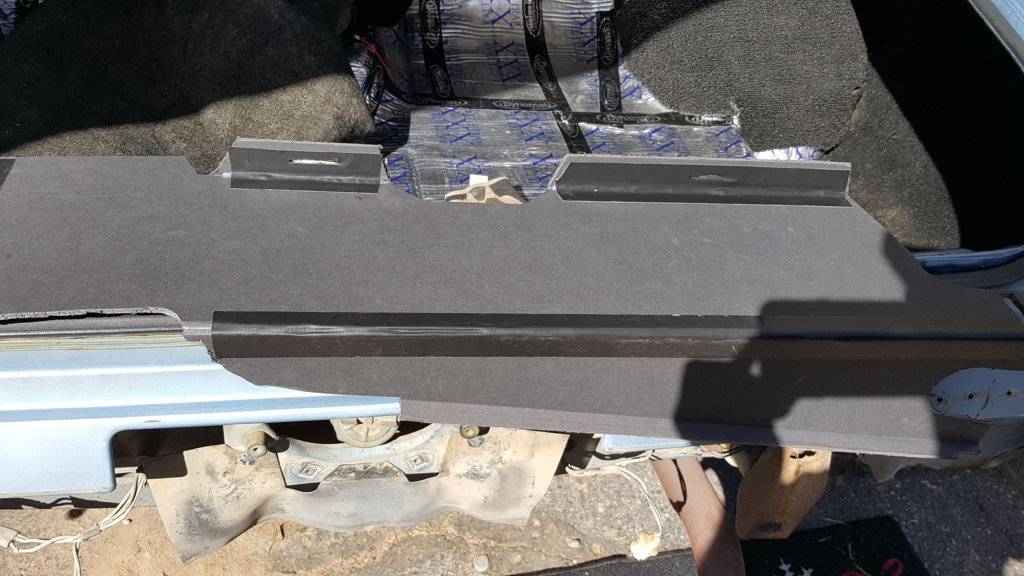

Progress Pictures:
Old Cardboard rear panels:
Foamboard replacement - I did no take into account the thicker foamboard when I traced the panels, so they became a little taller than the originals:
