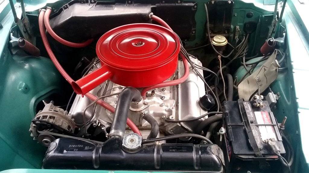

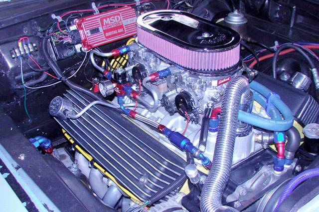

Very neat, Wil. What are ya gonna do to that Poly Head? You KNOW what I would like to see. . .
Yes, I know Rip. Don't hold your breath. :poke:.
This is really close to how it is suppost to look, (except for the red hoses). And is how Virgils 318 will look.

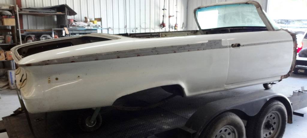

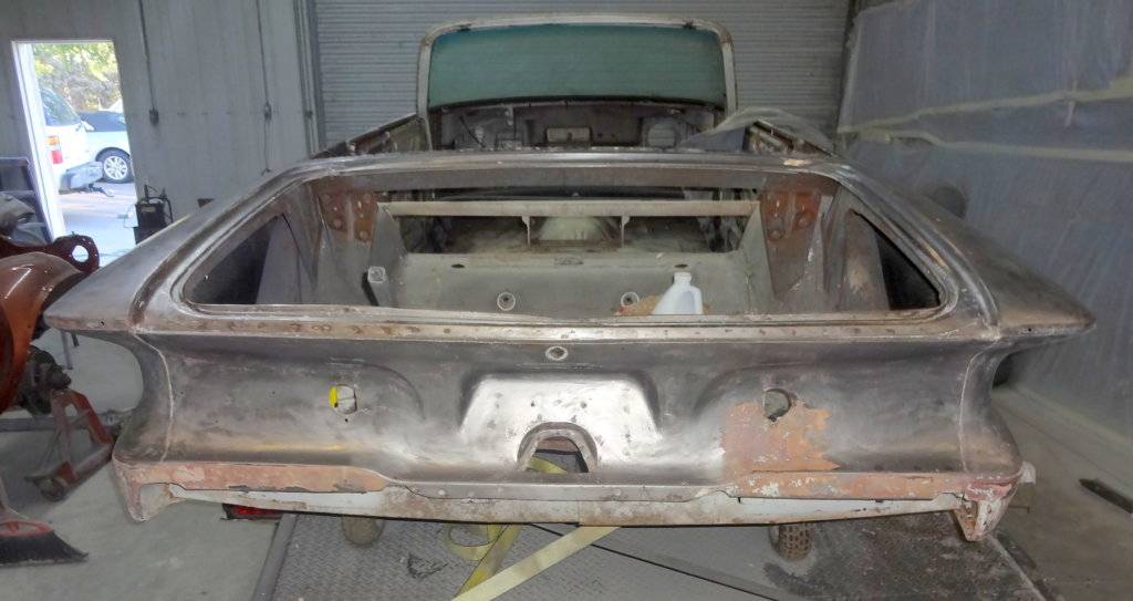

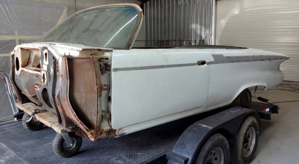

All cables, linkages & wiring between body and stub frame are disconnected. 8 bolts and the body and stub can be separated.

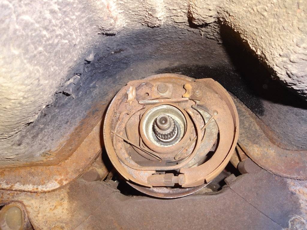

I was happy the hand brake assy and drum look great. I'll just need to clean up and reuse everything.
I would replace the wheel cylinders and other brake parts to be safe. If a seller says they replaced brakes or rebuilt the front end my dad will still go over it . He does not trust what they say.
I would replace the wheel cylinders and other brake parts to be safe.QUOTE]
Good advise. The brakes on Virgil have been all redone. The rear axle in him is from a 1968 Newport which eliminated the trouble prone original tapered rear hubs and the trouble prone brakes. It now has a bit larger rear drum brake with current parts availability.

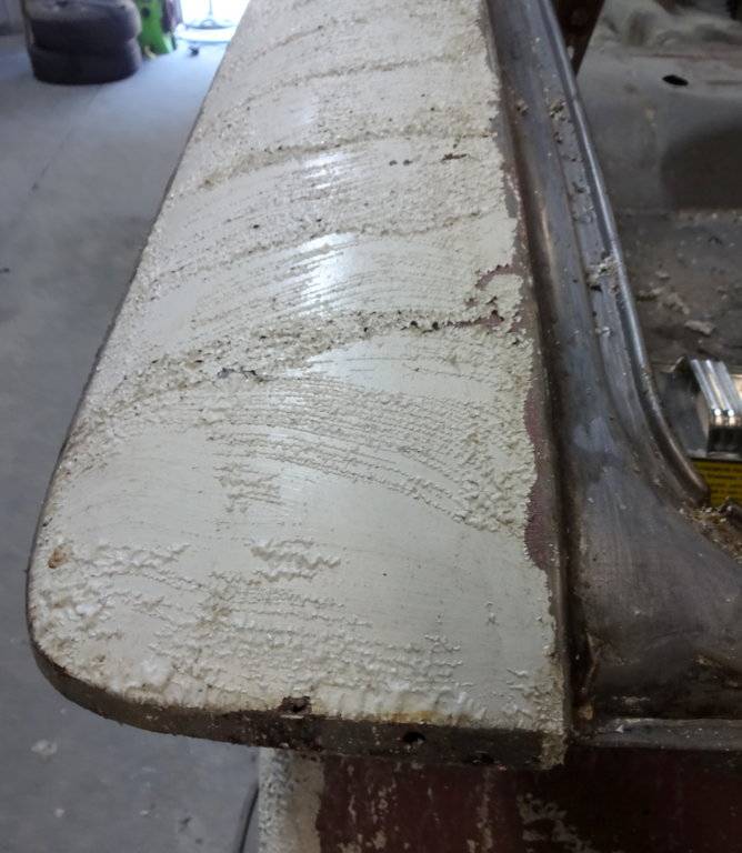

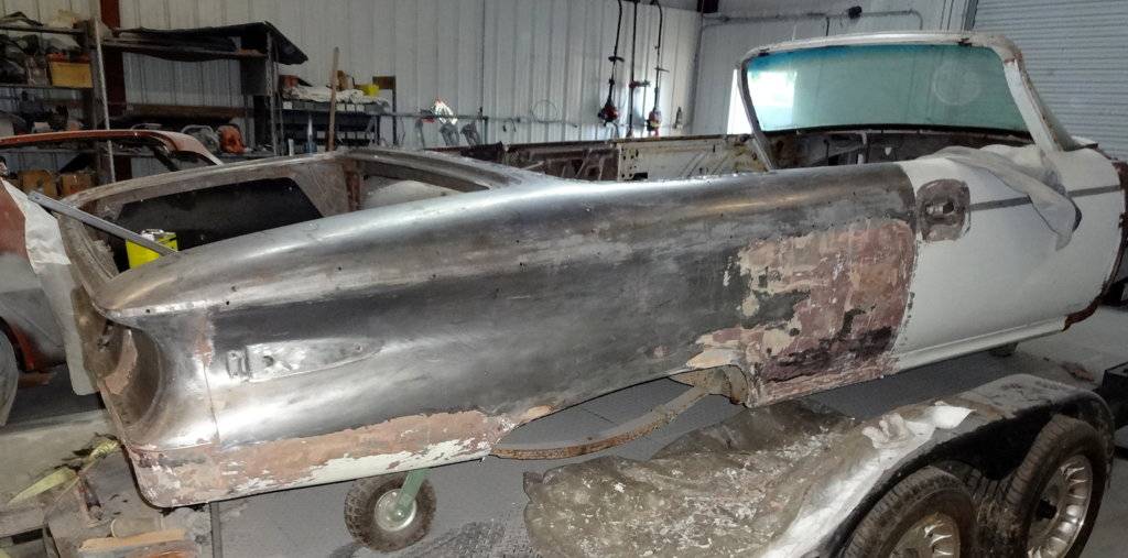

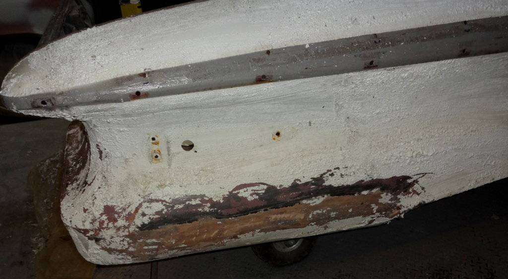

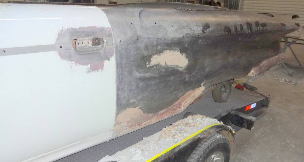

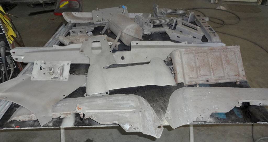

Clean, strip & prep on Virgil's body and related parts.
I'll have all the paint stripped from him by the end of the day. then sand blast the underbody, interior tub and trunk.
