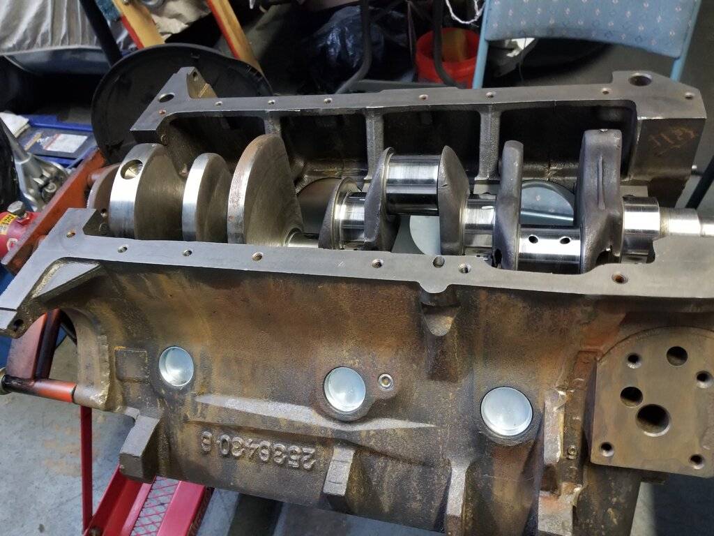

The 440 rebuild is coming along too, but it hasn't been worked on as much as the rest of the car as of late. @Xenon was out to shop last week and gave some hands on guidance on setting the tolerance on the main bearings to the crank with plasigage. We'll be doing the same with the rod bearings soon. Once the Total Seal rings arrive this week the rotating assembly will be finished and then onto getting the engine reassembled and dropped back into the car.

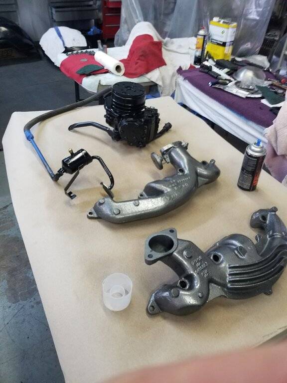

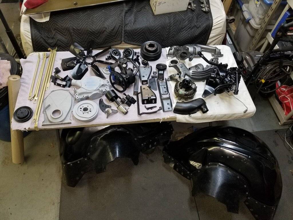

I finally took down the paint booth this week and freed up some floor space, for a short while anyway.

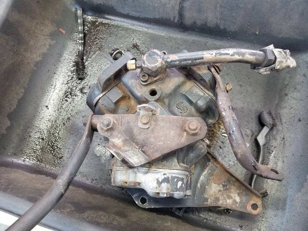

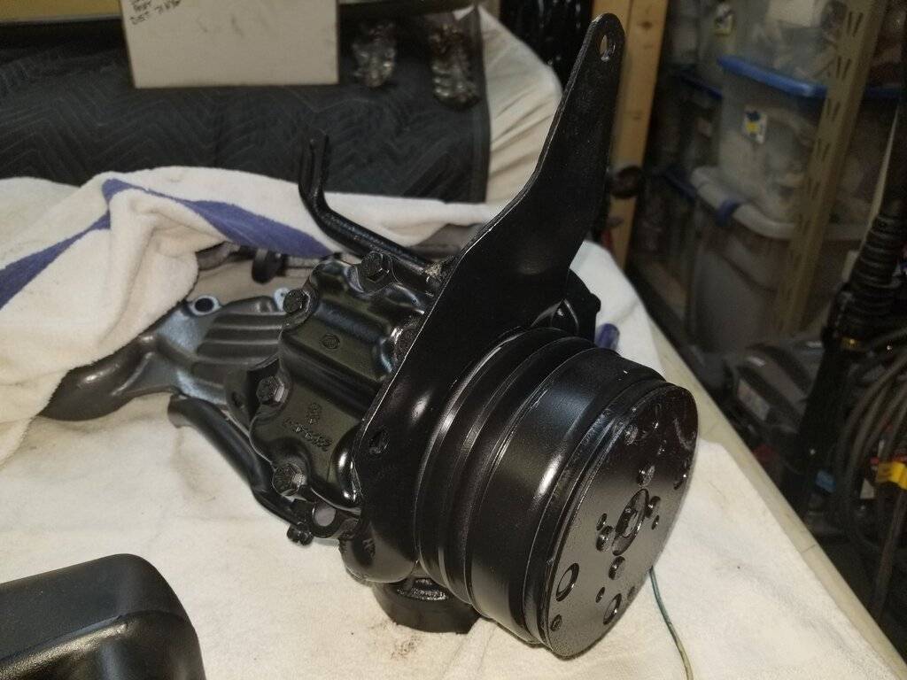

But before it got taken down, I spent a few hours cleaning up the AC compressor taking it down to the bare metal, spraying it with primer and then black paint.

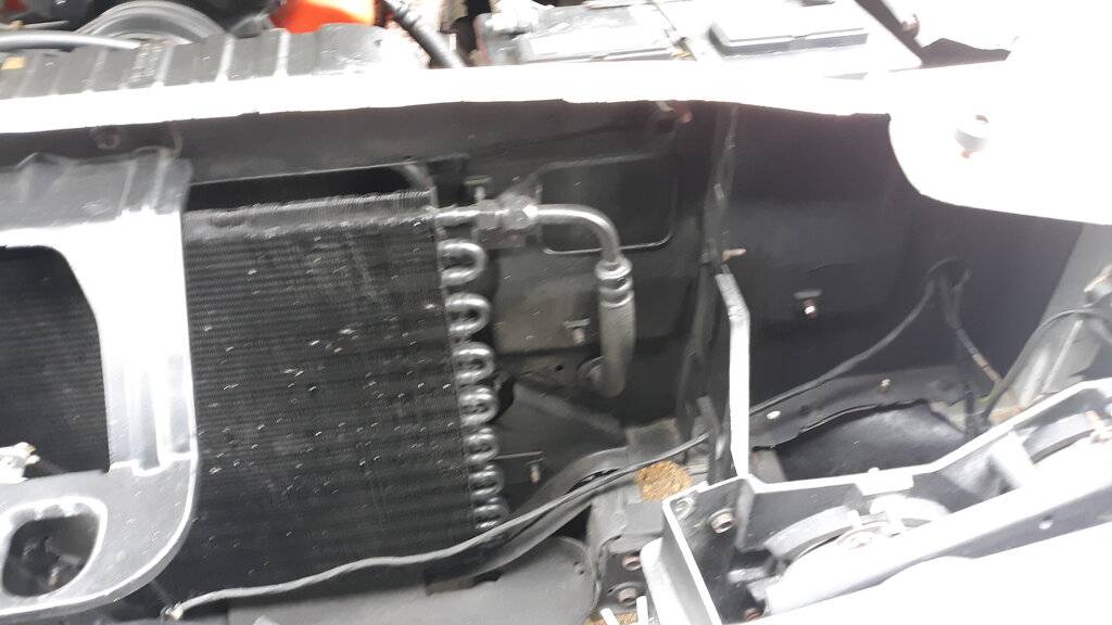

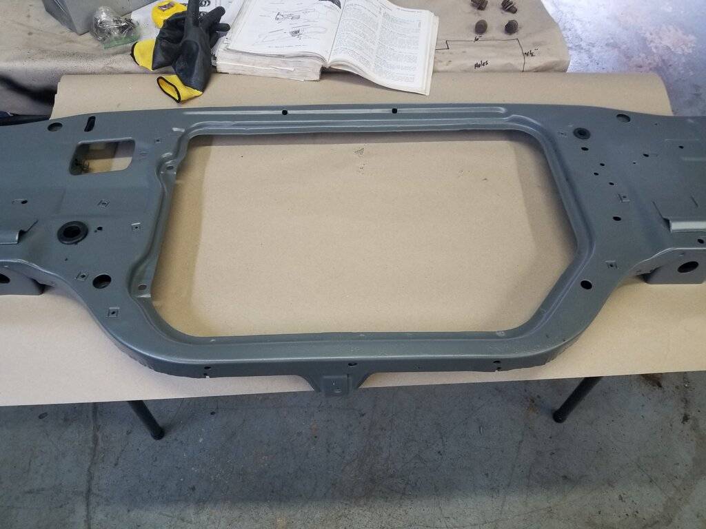

I took @david hill 's advice and blacked out the front of the core support.

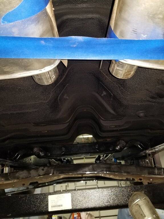

The undercoating on the New Yorker was all in tact, but it needed a little help. A friend of mine suggested Iron Armor after spraying the underside of his Jeep. After seeing it, I thought that was what I needed to spruce up the bottom of the car.
Spent some time under the car with a vinyl brush and removed any loose road grime before spray went on.
Hearing how POR-15 sometimes flakes off, I went this route instead, but I will be hitting the rust prone areas with POR-15 on the inner fenders and around the rear bumper area before they go back on.
If using this undercoating, be sure to use gloves. This stuff is hard to wash off, as I learned the hard way.:BangHead:

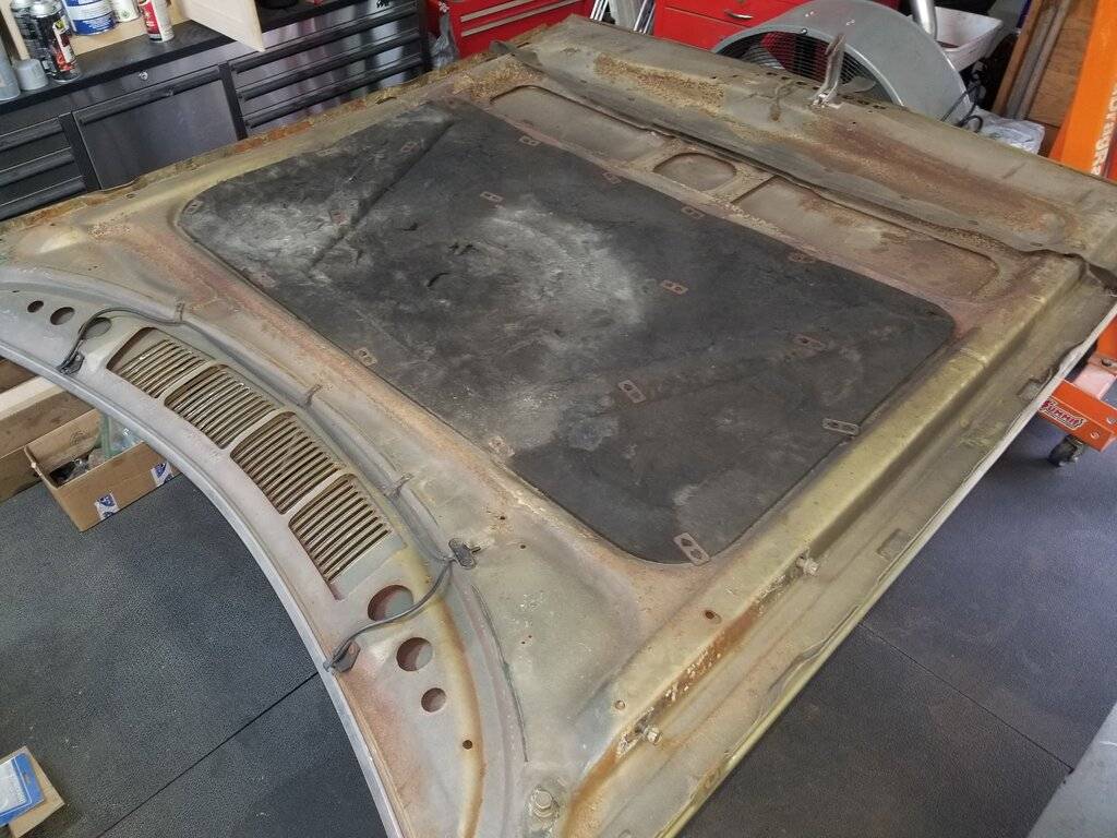

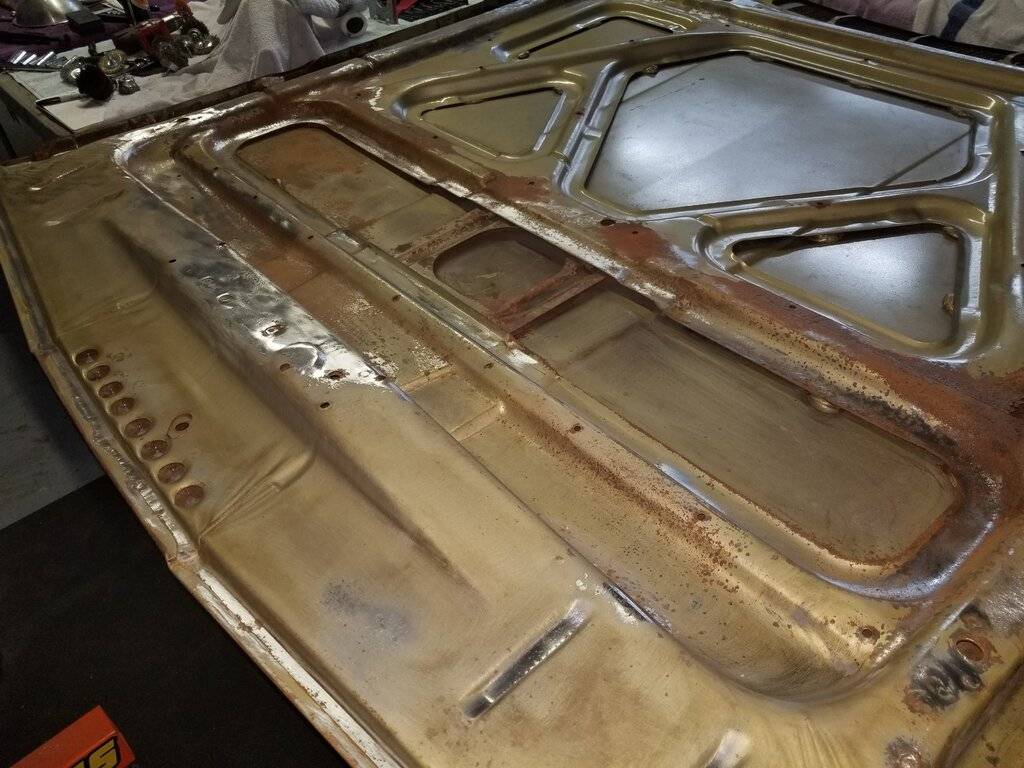

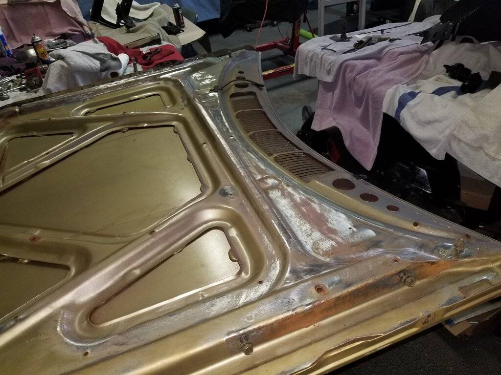

So that open floor space I mentioned above didn't last long after I took down the paint booth. The hood will be getting its final painting soon, once the surface rust is removed and sanded down to make it more presentable than the way it looks now.
New under hood insulation and clips will be added too.
