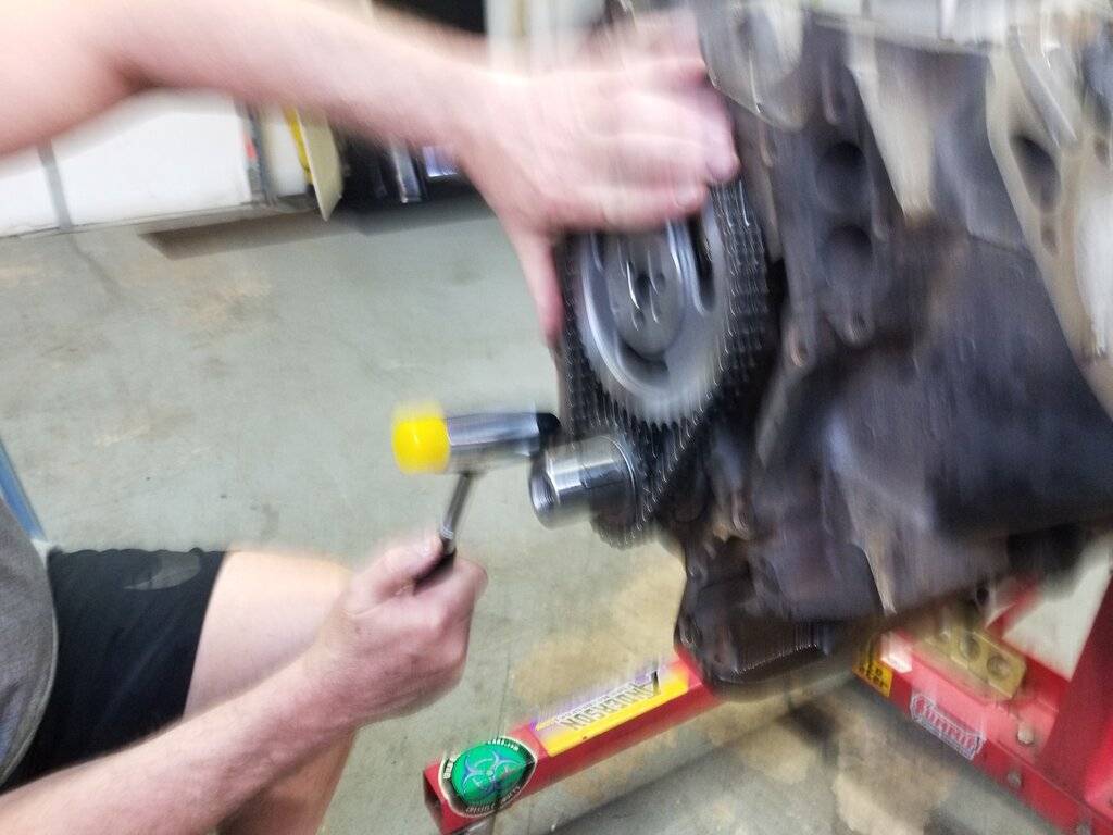

Torqueing the connecting rods to FSM specs and installation of the cam went as planned, however the 3 ARP bolts for the cam from 440 Source required some needed finessing to the timing chain cover so they would no long rub. Once seeing where the marks were being made, after a few taps with a hammer, and refitted for clearance, the problem was solved.
I usually don't like being in these pics, but yeah that's me, gold chain & all..:poke:
That little plastic hammer sure packs a wallop!
It made the whole area shake when you were installing that timing gear!:lol:
can't imagine the vibration feedback you felt going up your arm!
All this caught on camera! Very cool!

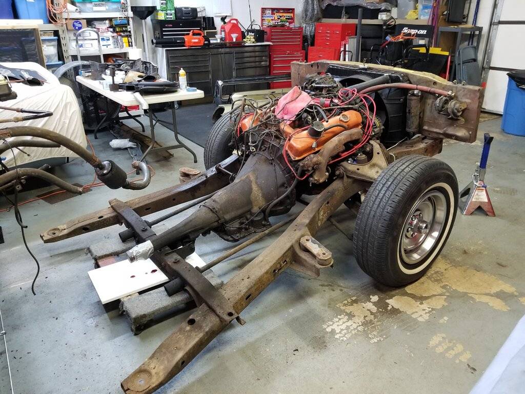

After pulling the engine last November and finding small chunk's of plastic or some other type of material in the screen on the pick up tube, and also the condition of one of the connecting rod bearings, I didn't think I had any other choice but to do a complete rebuild.

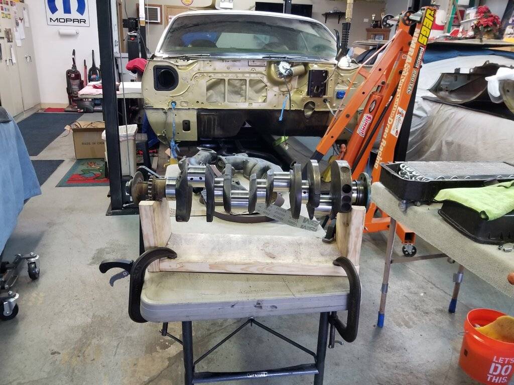

The crankshaft was not machined, because I learned when these cars were built, the crankshafts received some type of specialize treatment or coating (I don't know what it's called) from the factory. If I were to machine the crankshaft, that coating would've been gone forever.
The journals did need some attention but not too much, so an Emory cloth was used to clean them up, by using 320, 400 & 600 grit, as seen in the pic below.
When @Xenon and I were setting the crankshaft oil clearance, it was set to 0.003 by test fitting the clearance two times, using Plastigage.

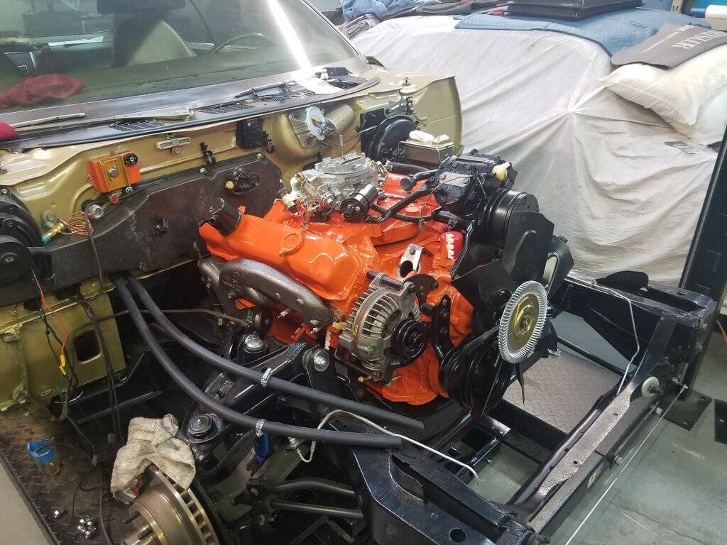

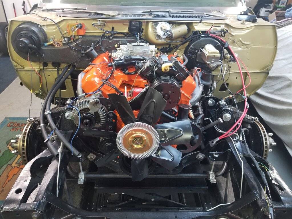

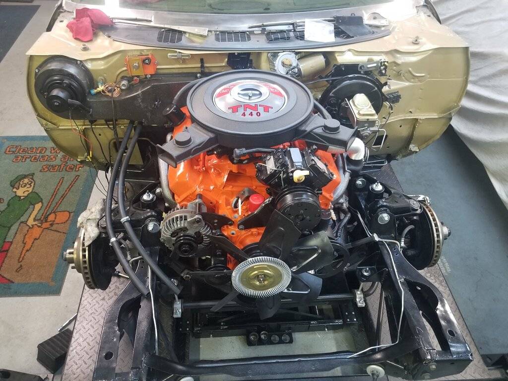

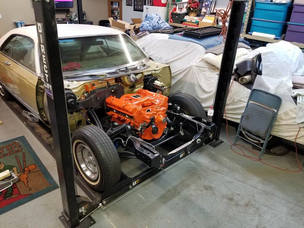

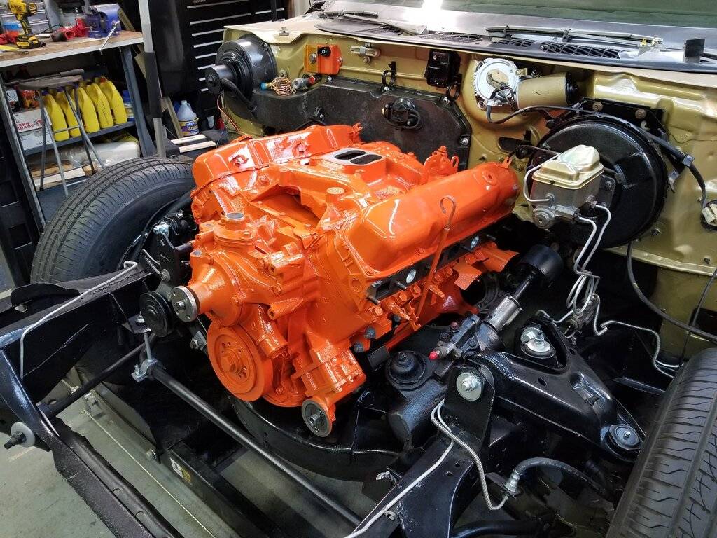

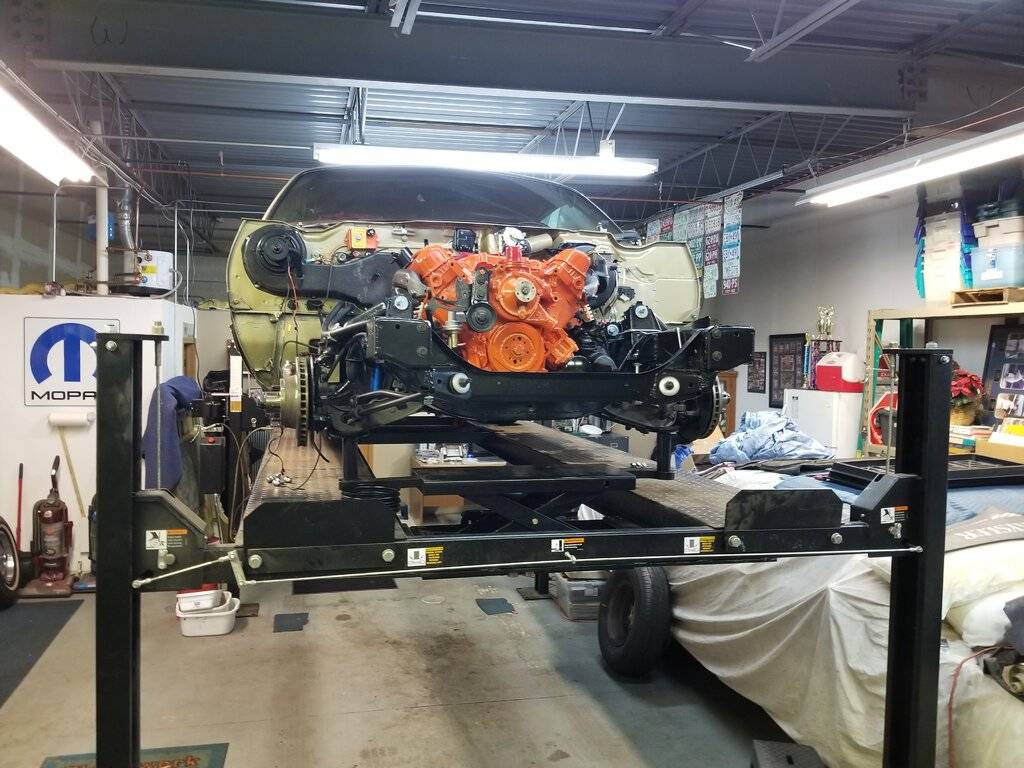

Today, the page was turned as the engine and trans went back into the New Yorker. Working with @Xenon makes doing this stuff seem easy, but it helps a lot when your working with a pro.
I've got my list to knock out for tomorrow, and if we stay on track, the engine will be primed on Thursday.
What a difference since last November....

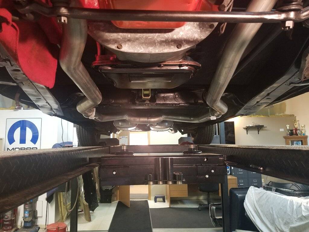

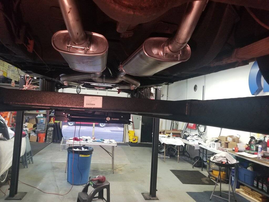

The last few days we all had a hand in moving the NYer closer to break-in the 440HP.

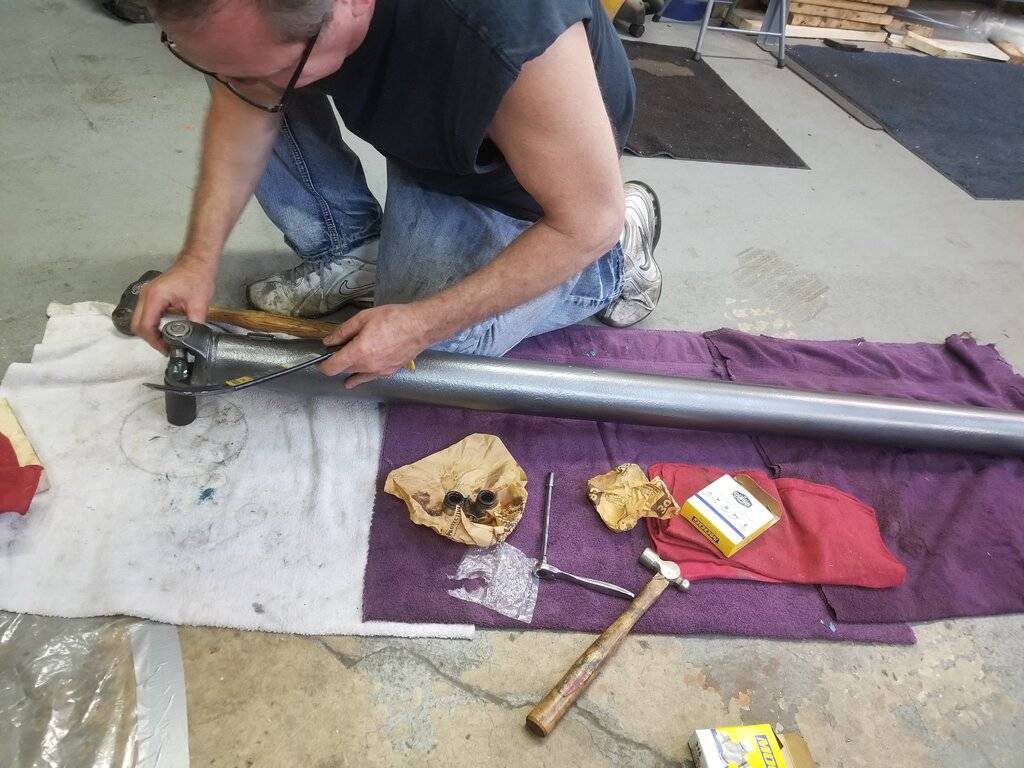

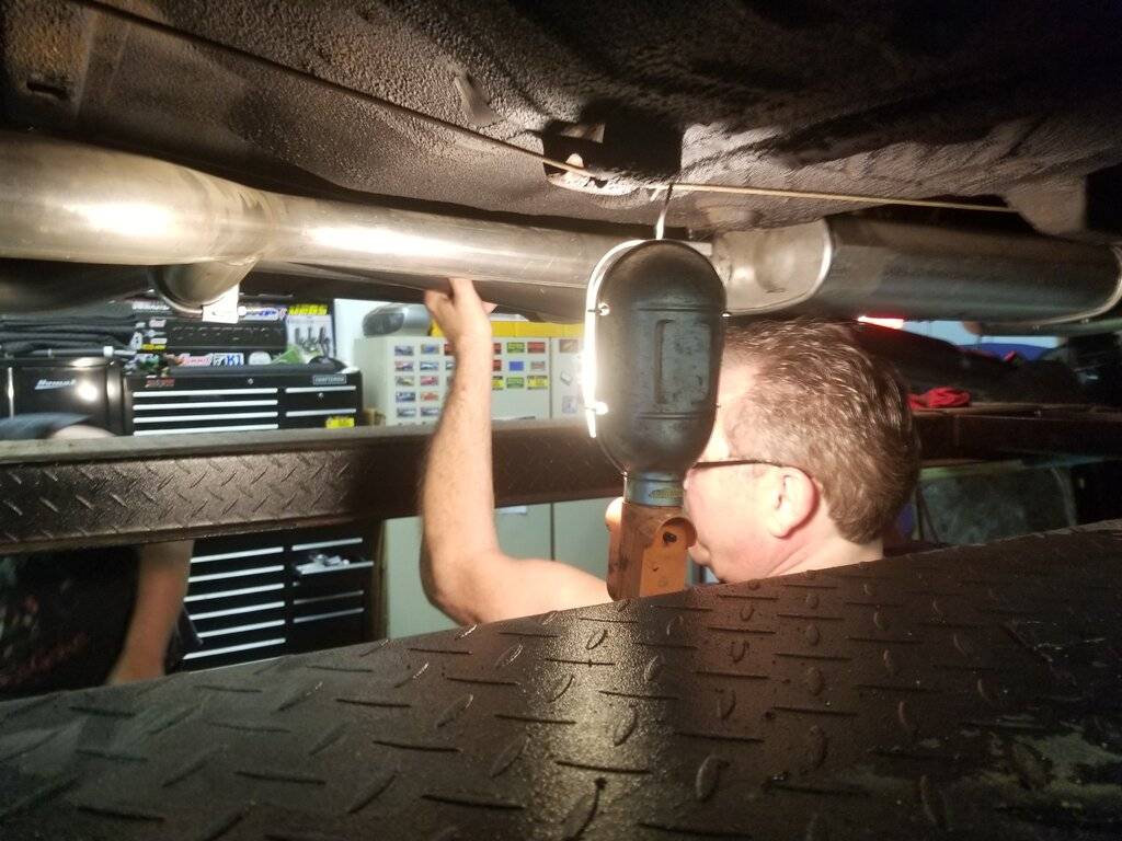

After the TTI was bolted back up onto the car Tuesday night, and then replacing the U-joints and soaking up more knowledge being provided by
@Xenon , the driveshaft went back in place.
