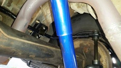

Just installed Firm Feel's Rear Sway Bar on my 66TC.
I'd say it's probably the BEST upgrade I've done other than installing Front Disc Brakes.
Body Roll is virtually gone, there is no longer that "boat" or "floating" feeling, there's no more wheel hops going over speed bumps and at speeds of 80 mph on the highway the car feels solid and steady.
If you decide on upgrading to one of these I've got some useful tips to make the install easier and more secure.

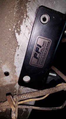

Yatzee, I don't understand what you're referring to regarding "drilling where a welded seam exists". There is no seam near the area the Frame Rail Bracket is installed. The bracket itself is a good grade material and I did suggest using the "thru bolts" rather than the self tapping ones FF provided. IMO the thickness of the bracket combined with using the "thru bolts" is far sufficient in taking up any verticle forces of the bar.
Let me add that the holes of the brackets are 3/8" and for my application I drilled 3/8" holes to match so there wouldn't be any possible movement of the bracket itself. I suggested 5/16" simply because it would be a much easier installation than trying to match a 3/8" hole exactly.
The studs coming off the Frame Rail Brackets to support the sway bar brackets are welded to the bracket itself. It was my thought initially that it would be best to spot weld the FRB to the rails, but I'm not racing the car around and figured the bolts would be more than sufficient.
The hole size seen pictured below was the suggested 3/16" from the instructions. As I mentioned the bracket hole size is 3/8" and that's the size hole I drilled using a 3/8" grade-8 bolt.

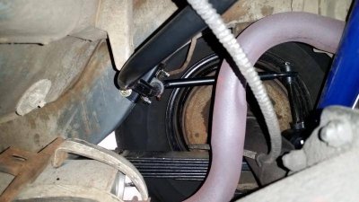

There was plenty of room to clear the exhaust even if I had 3" pipes. This weekend I'll shoot a better photo of the clearance if you'd like.
How did your exhaust clear? I have 3" pipes going out the rear and wonder how much room I'd have.
That would be helpful. I looked back through my pics when I installed my exhaust and I don't think it should be an issue, but it would be nice to see where it goes.

LocuMob,
As you can see from the photo there is plenty of clearance between the sway bar and the exhaust pipe - at least 5 inches.

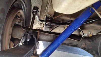

This photo also shows a good example of why I did the write-up for installing FF's sway bar correctly. I went by their instructions and you can see where they failed me. As you can also see in the photo my end-link is NOT exactly VERTICLE. Had I done what I wrote under "I SUGGEST:" I would not have had this issue. If I move the Frame Rail Bracket (FRB) HIGHER by about 1-2 inches the sway bar ends would move towards the rear of the car enabling the end-link to be positioned PERFECTLY VERTICLE. That 1-2" extra would also have given me enough clearance to remount my muffler hanger to its factory location.
As I do not want to drill additional holes in the frame rail to correct the mis-aligned bracket, I will simply bring it to my buddies shop and use his drive-on lift. I can then easily remove the bolts, bump the Frame Rail Brackets upwards to align the End-Links verticle then have the brackets welded in place.
So if you have access to a drive on lift you can do the same, but first install the End-Link brackets that installs between axle and leafs. Even if you personally don't have access to a lift it really shouldn't take a shop longer than 1/2 hour to install and align the brackets, sway bar, end-links and weld on the brackets. Time is money and you'll save yourself a good amount of time not to mention saving your knees and back. Hope this helps - Good Luck!
