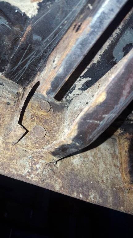

Just a few words about Chrysler quality control back in the day... One side of the Stub frame bracket is bolted like it should additional to the welding spots, the other side is not.... The bolt holes don't line up so they simply skipped bolting the bracket to the rocker... But hey, it lasted 48 years...

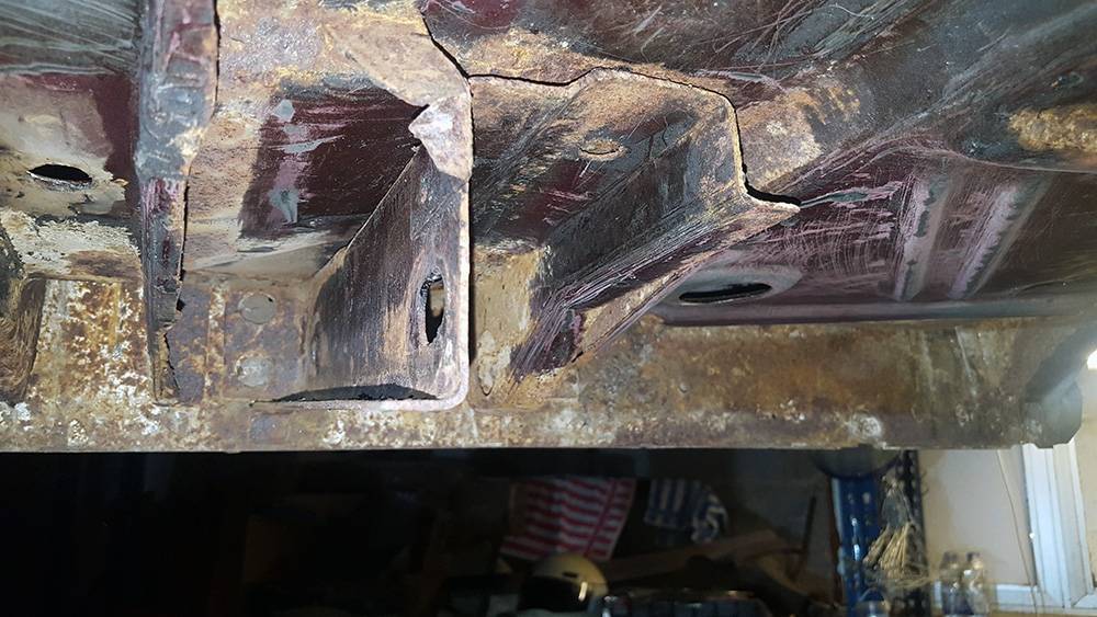

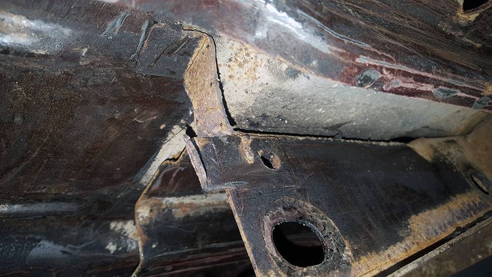

On both sides, these holding tabs are 'cut'. Are they supposed to be cut?

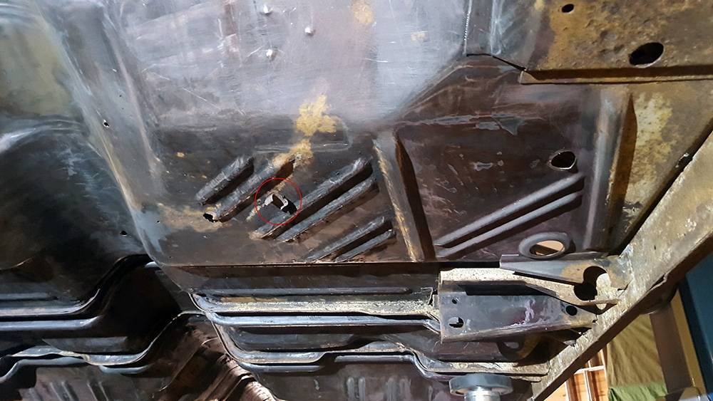

What is this clip for initially? It's on the underside of the drivers floor panel. There was nothing attached on my car.
This is exactly what my '70 300 looked like, a random clip, and the support tabs on the stub reinforcements looked broken. I ended up lining them up and tacking them with a couple of welds just to be sure.
Speedo cable for sure.

Nice job in getting the undercoating off the underside of the body - it looks like it did its job over the years of protecting the floors and other areas. Not sure about whether the holding tabs should be cut, but I can try to take a look under mine. Usually, though, that clip you are referencing is usually used to hold the speedometer cable that goes from the transmission and up through the lower firewall and into the speedometer.

Thanks, the speedo cable makes sence! So a new clip is going there!

Yes, I thought it was odd as well, must have been something needed in assembly but not wanted later, line something up but not restrict flexing?

That's what I thought as well. I'm not sure now if I should reattach them or cut them away.
