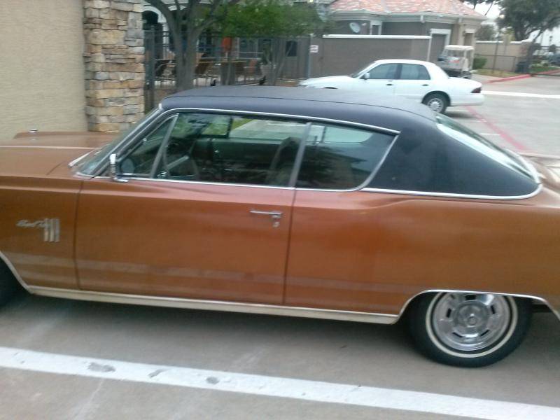

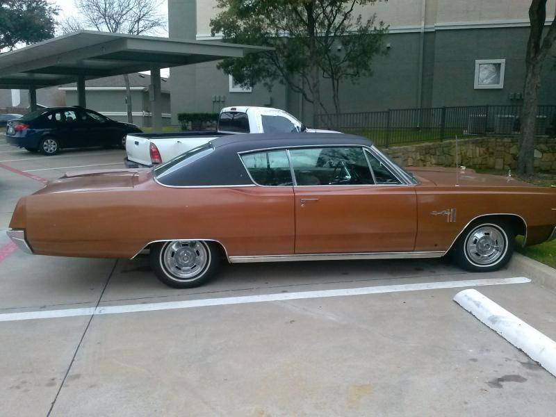

Hey Guys, I FINALLY got my car back. The guy did a pretty lousy job too. The vinyl top itself is ok, but the issues are: there us glue all over the chrome, the chrome no longer lines up, there is vinyl hanging over the chrome (not tucked under it) in ne area, there is some kind of spray that is coating the back window, the rear seat is no longer firmly attached, a chrome piece over the door now has a noticeable bend in it, but oh, he did keep the price at $450 haha.
Here are some prelimary pics. There was some substance that had run down the glass, luckily I was able to clean it off. In one photo there is discoloration, it better be some kind of oil that washes off.

View attachment 25051View attachment 25052
Exactly why you want to learn how to do any work on your wheels yourself. No one appreciates your car more than you. Can barely see the imperfections, but nice Plymouth overall.
10 foot rule Gary. Everyone's car looks great from a distance.....especially in pictures. I see something all over the C-pillar. Could be glue. I would be upset finding glue all over the chrome and vinyl and the chrome not lining up properly.
Yeah I get it, but I was meaning over all. I've seen cars people drool over that were all but rusted wrecks....so this is a super nice driver quality set of wheels. I wouldn't be embarrassed to tool around in.
