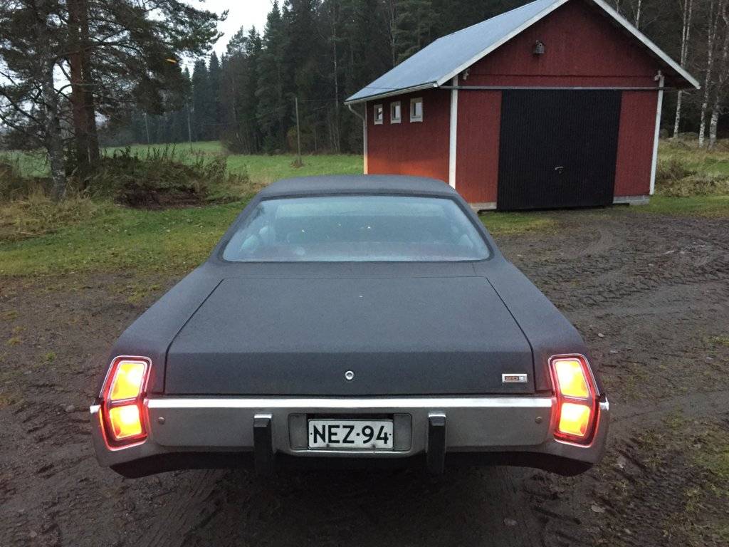

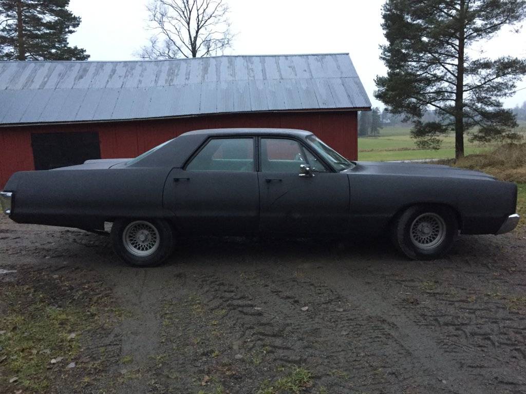

    This is where we start the holy shit.

    Gotta say, that ass is up there. Way too much for my liking. But just eyeballing it, if you get the ass down to a normal height, you may not need much adjustment in the front lest you really want it.
    Damn, I love the taillights on that thing!

    I agree, take care of the rear first.

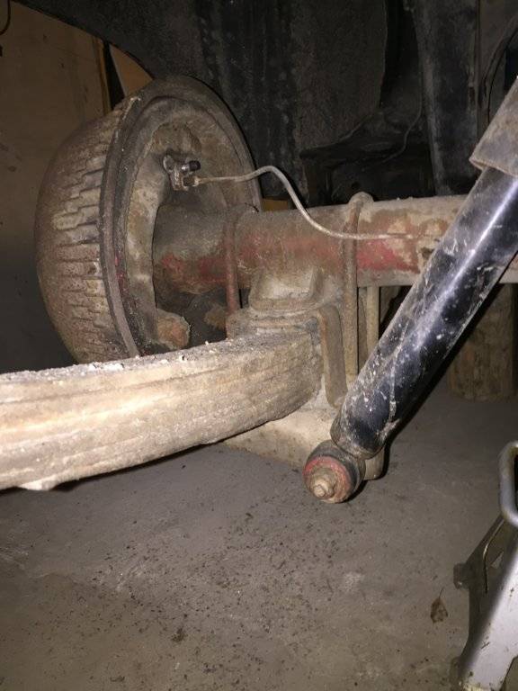

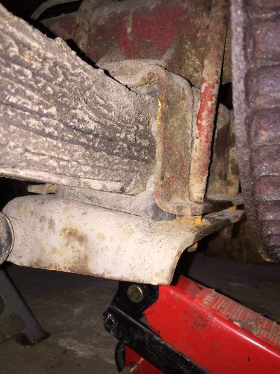

    So I took it apart:

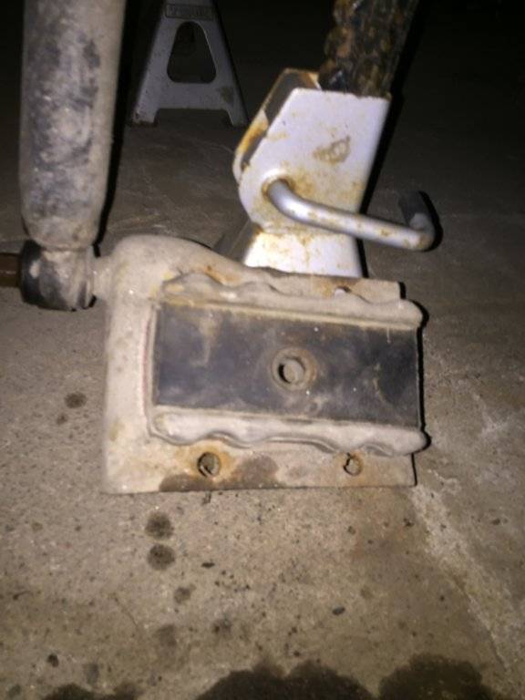

    This is original. And thats the lower rubber I'll use to get the rear axle into right place.

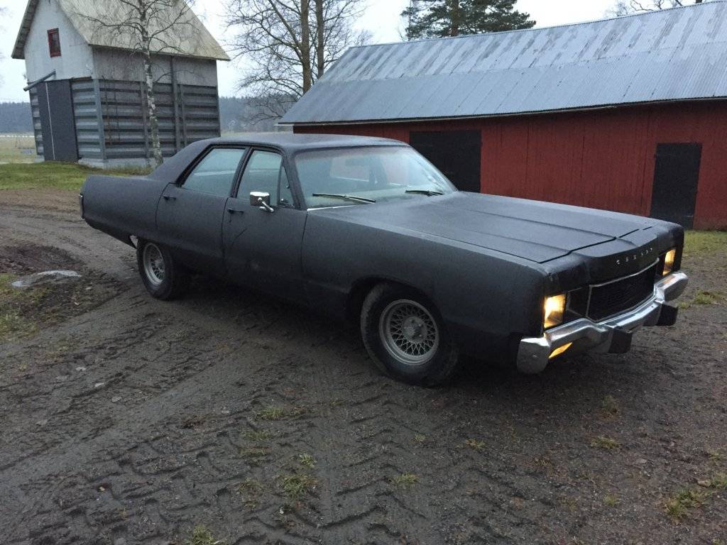

    Posting a photo of how the car sits now helps quite a bit, lest you think it's just that people aren't "kool" with your thoughts... we've been asking for those pics through many postings.
    Are the airshocks removed in that photo?
    None of this talk of adjusting the t-bars until that is done. That's also not going to "tighten" your front end, if your are speaking to steering play.
    You need to return the car to its stock condition before you lower it, not stack modifications to counteract other modifications. Otherwise you just end up with a clüstërfück to put it in terms you'll understand.
